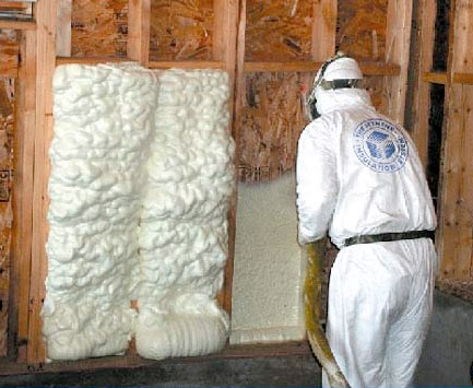

    One way I've been able to 'avoid' some of the prescriptive limitations (like the cathedral ceiling limitation Lynn points out) of the building code is by using N1101.8 Above Code Programs. This permits the local official to deem an energy efficiency program to exceed the code requirements. This provision is unchanged from the 2006 IRC so I've been using it for a few years. I get my projects certified under the Energy Star Home program and submit the approval certificate to the building department.

    I am want to build an active solar home using concrete sips for the walls.the south side of the home would have a sunspace with the heat rising into the attic and then blowing the heated air down between the joists and the drywal on the north wall.Since I am using a SIP the space between the studs won't be insulated and the empty space can serve as an entire wall duct system. I don't want a vented attic for obvious reasons! My plan was to use two inches of polyiso directly against the underside of the roof decking to stop infiltration and then use 14 inches of of fiberglass insulation (r52). Would this work or would I have a misture problem? [email protected]

    Q. "My plan was to use two inches of polyiso directly against the underside of the roof decking to stop infiltration and then use 14 inches of of fiberglass insulation (r52). Would this work or would I have a moisture problem?"
    A. Whether or not this will work depends on your climate zone. For more information, see these two articles:

    1. Yes, you can install a second layer of OSB on top of the polyiso.
    2. Check with your local code official to be sure that 2 inches of polyiso meets local requirements for the minimum R-value of rooftop foam. Remember, the more air-permeable insulation you install between your rafters, the thicker the polyiso has to be to keep the OSB above the dew point.
