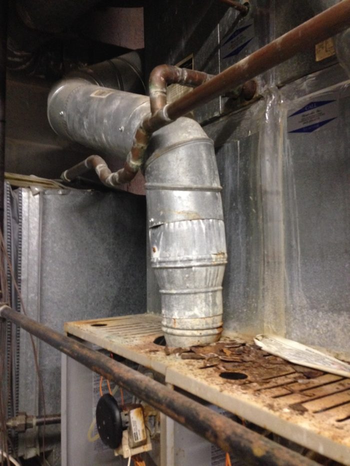

It didn’t work out that way. Within days of purchasing the house, in the depths of a late winter cold spell and icy snow falls, the monster in the basement started buzzing whenever it was activated. At first it would buzz and then gradually settle into the normal hum of an air handler (more of a rumble, in this case). Over a short time, it became apparent that my desperately crossed fingers were cramping up to no avail.
Despite a total of 210,000 Btu/h worth of furnace capacity, the house would not reach the set point for hours, and struggled to maintain it. The buzzing worsened and one air handler started cutting out. I went down and took the cover off to examine it and rust poured out onto the floor. It was literally falling apart.
Now that I had to figure things out, I realized that the two air handlers were actually both feeding one big supply trunk (see Image #3, below). One big return connected to the intake on the bottom of one of the twins. Presumably, a hole had been cut in the opposite side to allow air to pass into the adjacent twin air handler’s intake.
It seemed that someone had decided they could create a 160,000 Btu/h furnace by taping two 80,000 Btu/h furnaces together. The side-by-side thermostats, then, were in one location because they were supposed to respond to the same conditions and activate the twin air handlers together!
