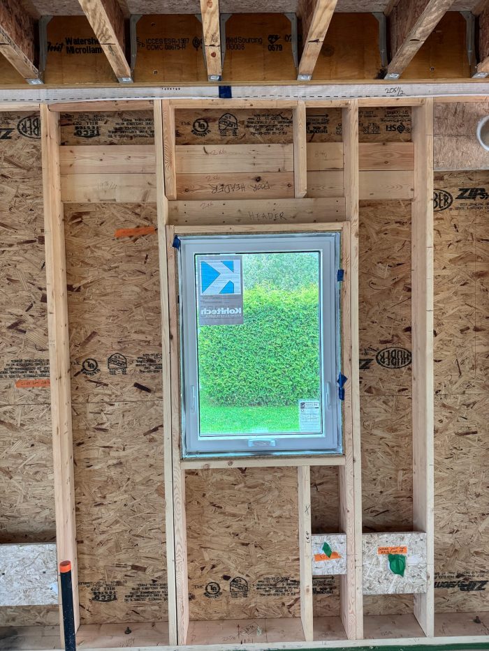

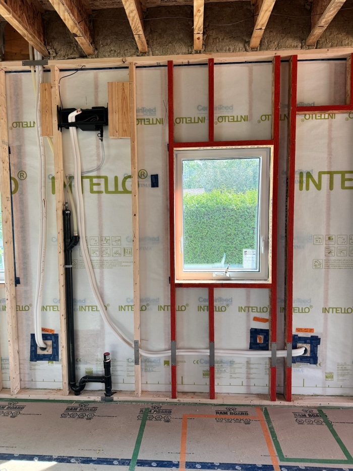

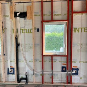

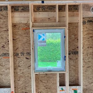

Lot of good options here. Our team has two preferred “pretty good wall” assemblies:
Starting from exterior:
1) siding, 1x3 rain screen battens, 2” mineral wool, mechanically fastened WRB (vapor open), CDX with taped seams, 2x6 filled with wood fiber, smart vapor retarder, interior finish
2) siding , 1x3 battens or drainable WRB (vapor open), cdx with taped seams, 2x6 exterior wall, 2x4 interior wall (staggered layout from exterior wall), blown in wood fiber or cellulose, smart vapor retarder, interior finish.
Option 2 can be thickened for more r-value but our budget version is 9” thick.
