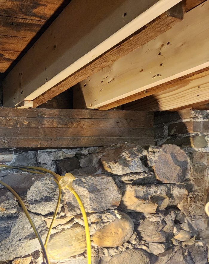

I live in a 150-year-old balloon-frame, stone/brick exterior house in Philadelphia. I have a quote for getting the attic spaces filled with blown insulation (for the first time!) and for air sealing in the basement. Having worked on wooden ships in my past, I’m leery of having closed cell foam applied directly to the rim joist, fearing that it will increase rot potential.
do you share my concern?

The original 1865 stone house was stuccoed and the plaster inside is right on the block (no voids). I'll have to check where the sill actually is on this part. The addition built in 1880s is brick with plaster/lath interior. There's a 1" void between. The addition's basement is partially below grade, with a mortared stone foundation. The addition is much colder than the rest of the house, with the basement being very chilly. I've ripped the plaster down in that basement and have been putting foam board in the 1" air gap. The house was built as a summer residence and had no insulation. It's a great looking house...

There doesn't appear to be any issues of concern for using closed cell polyurethane on band joist and stone in that basement picture. The foundation sill appears to be WELL above grade, and putting even an inch of spray polyurethane from the subfloor to the slab (or dirt?) would lower, not raise the risk of moisture problems in the timbers. The roof overhangs appear to be plenty for keeping the splash-back under the eaves well controlled too, and even if the surface grading is sub-optimal, you're unlikely to create a problem by insulating the basement and band joists with closed cell foam.
On the all brick section there is likely to be a ledger board, or mortise holes in the masonry, or iron joist hangers for supporting the joists. That too can be insulated, but a picture of what you have might be useful.
