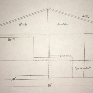

Ive drawn up so many plans and ideas for my bug-out acre in Iowa, but keep circling back to a simple attached garage shouse. I need raised heel scissor truss’s to get the 14′ ceiling height with 9′ sidewalls but I’m wondering, what is the maximum angle the bottom truss cord could be without having 16″ of cellulose sliding down to the eave?  I could always use something like plywood dams or netting to prevent that.  But is there a rule of thumb where I wouldn’t need dams?

    My problem is Id like the recommended R60 (faced batts available only to R38) and can order raised heel scissor trusses, but what's the options for ventilated R60 without spray foam here? Can they install netting and blow through holes, or ive read work from the peak and lower the hose down the net 28 feet, because there's not much room for a worker to access scissor truss space after drywall?
    Or am I stuck with R38 realistically? I really don't want the 14' sidewalls usually required for a car lift. The plan does not have scissor truss's drawn in. Thanks!

    Ive drawn another drawing, but I'm coming to the conclusion insulating scissor trusses with fluffy stuff or anything other than with R38 battens, which maybe adequate for a garage, is very difficult and I remember last time I considered it I was stumped too. . But maybe since I have scissors in the garage side only, I can access them from the flat ceiling home side? I guess this is best asked to the installer.

      As Charlie said: I think limiting blown cellulose to pitches of 4/12 on scissor trusses came from situations where the insulation sat on the bottom chord and was not constrained above. In your situation where the cellulose will be sandwiched between the ceiling and vent channels, I'm sure you could go to 5/12 with no problems., or necessity to dense-pack.
      Given that, I'm wondering whether when the pitch of your bottom and top chords are so close it wouldn't make sense to just use parallel chord trusses with a consistent depth?
  8. charlie_sullivan | | #14
    I agree that accessing that from the flat-ceiling side would be the way to go. And it looks like you'd basically be packing the full space between the ceiling and a ventilation baffle, which would go all the way up. Almost more like filling a wall than blowing insulation in an attic. I think it will work well.

    Thanks but Ive drawn these scale scissor trusses with 24" heels and with a span of 28' are 5' tall at the top guys.. Considering I need 16" of cellulose to achieve R60, packing these spaces would be way overkill for a garage. And I didn't plan on using baffles.. I planned on holding the cellulose away from the roof decking..
    Again, unfortunately it sounds like using faced R38 fiberglass is the only realistic answer except for the wind washing.. Especially with a 28' span.
