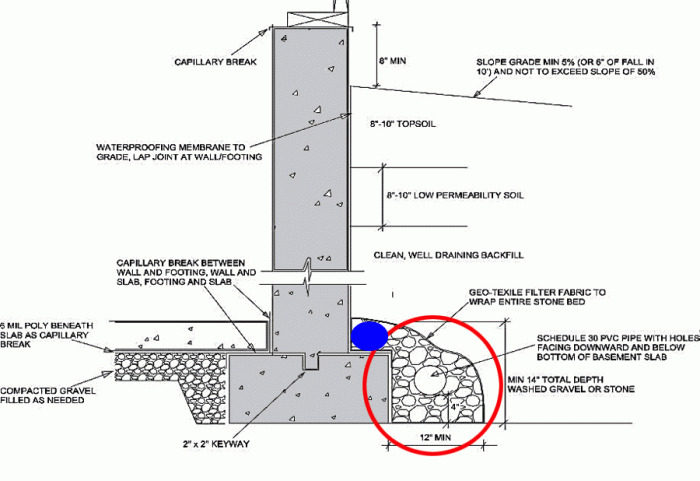

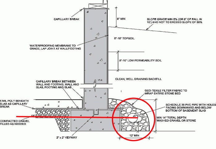

You actually bring up an interesting point... I was always planning on running the french drain alongside the stepped footing, but I guess it wouldn't make sense if that footing is far below the slab. You're suggesting just run the french drain at the slab level, like in the attached drawing, correct? This side has a more dramatic step where the other side is more gradual and frequent.
There will be a passive radon system installed and a complete vapor barrier, yes.
I guess my question was also, do we care about the soil beneath the slab's water content?
