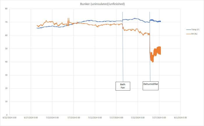

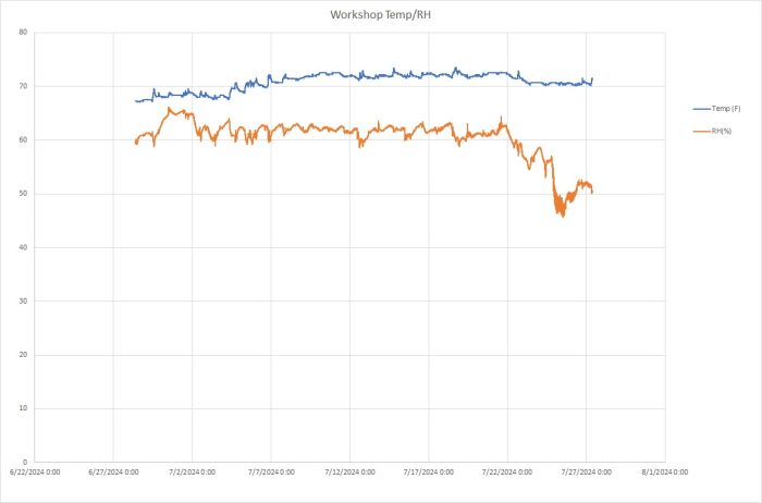

As an experiment, I installed a Panasonic WhisperValue bathroom fan in the bunker and have it exhausting through one of the 3″ pipes to the outside (which I uncapped and finished off with a roof hood). I’m running the fan around the clock at 50 cfm, so it’s pulling the air from the bunker and presumably from the semi-finished room next to it, and exhausting it outside.
This brought the humidity down to about 62%, much closer to the humidity level of the semi-finished room 59%. The mustiness level has also decreased.
I’m wondering if there’s an additional benefit to opening up the second pipe, so as to allow outside air to be pulled directly into the room? I’m not sure how much air would get sucked in through a 3″ pipe when there’s already a fully open door in the room. But the outside air would obviously be “fresher” than anything coming in through the door to the other room.

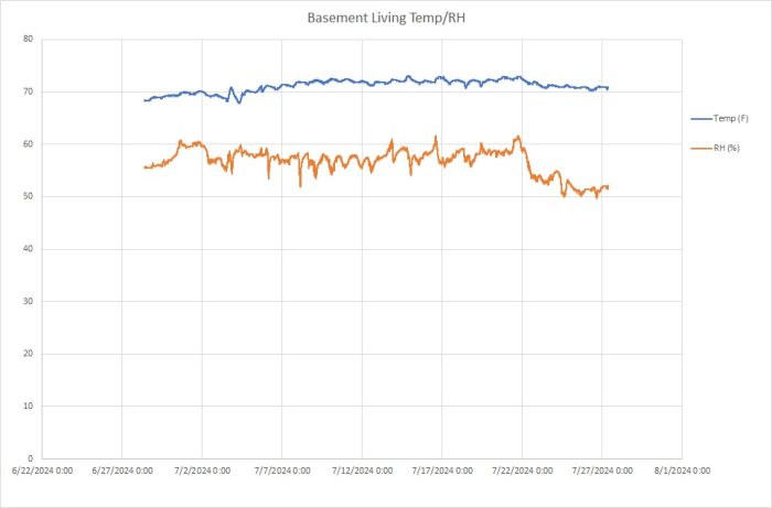

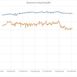

Relative humidity doesn't mean much without also knowing the temperature. Is the temperature consistent between the spaces or does it vary?
Michael, the temperature in the bunker is hovering between 70 and 72F. In the semi-finished room next to it the temperature is between 72 and 74F (RH around 59-61%). In the finished area the temperature is between 71 and 73F (RH around 55-63%). All of these areas are not conditioned in the summer. The outdoor temperatures have been in the 80's and 90's for the past few weeks.
Those are nearly identical moisture levels; just a couple of degrees makes a difference when it comes to RH.
As I think I've heard Joe Lstiburek say, dilution is one solution to pollution--i.e., venting the air continuously is one way to address your problem, but it's better to find and address the cause. I still believe that the most likely cause is moisture in the walls--from moisture in the soil and also from indoor air condensing on the cool concrete. Adding foam insulation, either rigid or closed-cell spray foam to the walls, and adding something like Dricore or Delta-FL dimple membrane, with at least 1/2" of foam and plywood or Advantech floor sheathing, should greatly reduce odors and improve indoor air quality. Having some ventilation is always a good idea as well, but if a single bath fan isn't doing the trick, I'd address the cause.
Yes, the bathroom fan has helped bring the temperatures and humidity levels in the bunker closer to the rest of the basement. That makes sense since the makeup air is coming from the other parts of the basement.

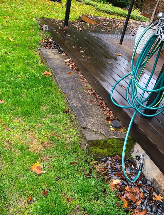

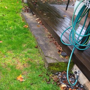

We're in CZ 4C, marine/mild climate. As to the question about what's above the bunker, the ceiling/roof functions as a patio above, so it's essentially exposed. Part of the patio is covered with wood decking on sleepers, and there's a roof overhang over that area. A very small portion (maybe 20-30 sq ft) has no decking and no roof, so it's exposed to the sky.
I'll be asking more questions later about HVAC in this house, as I'm struggling to keep the main floor properly conditioned. The house was recently remodeled top to bottom (just before we bought it), and they tried to make good choices (insulation, mini splits, hydronic floor heat), but the execution was lacking in a number of areas. As to the previous comment, I also am usually not a fan of old houses, but this mid-century modern has tons of character and was very nicely remodeled, so we took the plunge (after trying and failing twice to get a new home built). Here are a couple of pics.
The portion under roof is probably ok but the exposed portion is not. You had said it was part of your basement so I assumed it was inside your basement, not outside your house. I have been in one similar space, which was saturated with water. You absolutely need to protect the exposed portion with something waterproof.
i'm trying to piece together the disparate pics to think about how much is not under a roof, might be they thought of that? If water isn't pouring in during a rainstorm after 50 years the probably did an ok job. I would get a name brand dehumidifier. I bought one with a pump for my garage because I need dehumidifying in the winter.
The use of this space is more like an attached garage than living space, so if mildew can be kept at bay with a dehumidifier, and you don't feel the need for a lot of heating, maybe not go crazy until you have spent enough time to determine how it lives.
I'll try to describe it better with the attachments. First one shows the main level, with the roofline of the covered patio outlined in orange. Second one shows the basement, including the bunker shaded in magenta. It's a walkout basement in two areas, but the bunker portion is fully underground. Third attachment is an overlay of the two floors, where I try to show that most of the bunker is covered by the roofline, except for a small bumpout. I'm not sure what happens in the bumpout, it's the area where the vent pipes exit, but it's not above the bunker directly, it's right next to it. Without digging everything up I can't tell why it's there, it looks like it's where the 3" cast iron pipes are routed to the outside. Finally there's a photo to hopefully illustrate this a bit better. Yes, it's a bit complicated.
The bump out is where the fallout detector goes............I would make sure the gutter stays functional

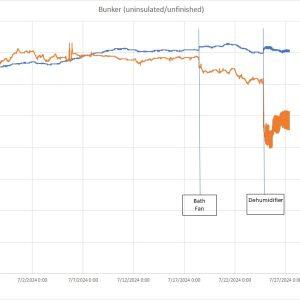

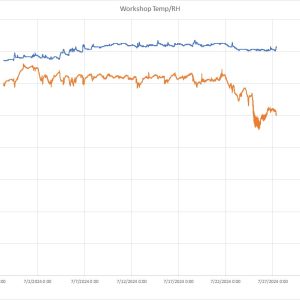

I put in an 80 pint portable dehumidifier yesterday, and within a few hours the humidity dropped from 60% to the 45% I set it at, and generated over a gallon of water. It also dropped the humidity in the adjacent room from 60% to about 42%.
So hopefully this will work as a solution without resorting to insulation - time will tell.

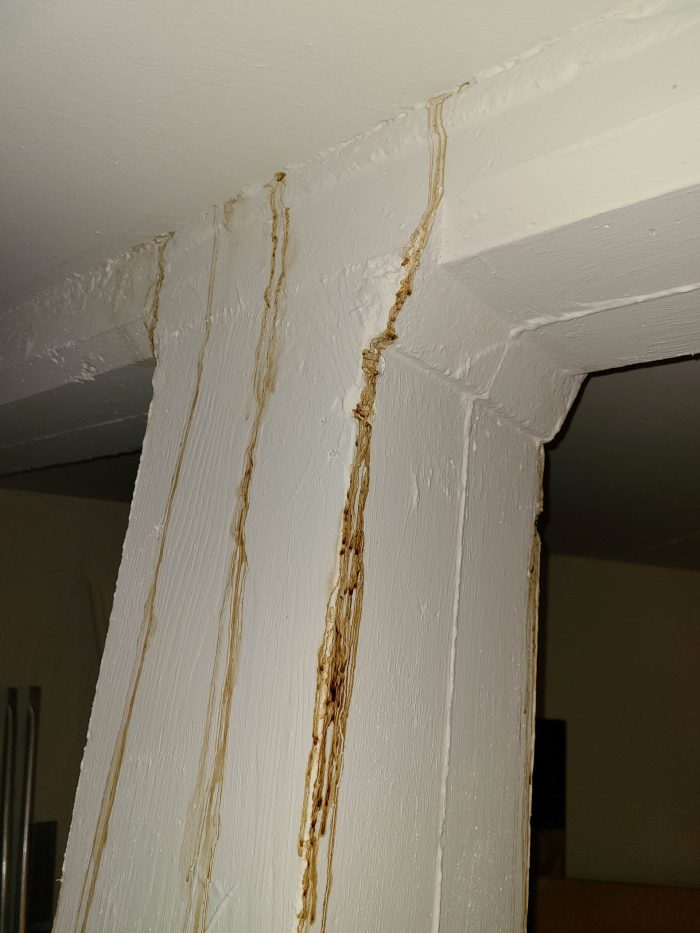

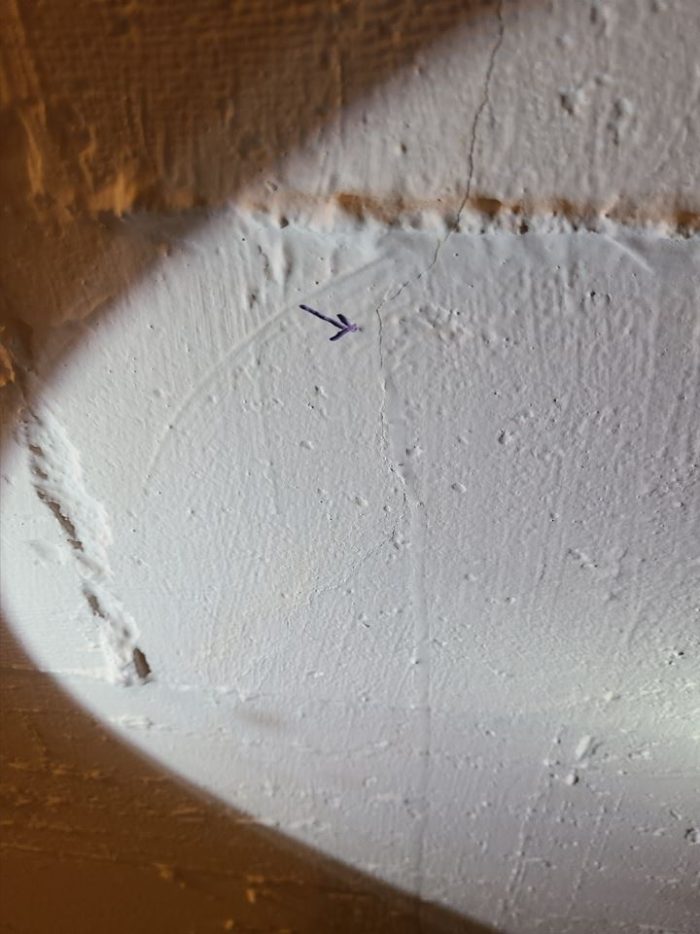

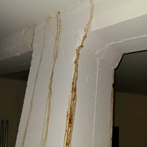

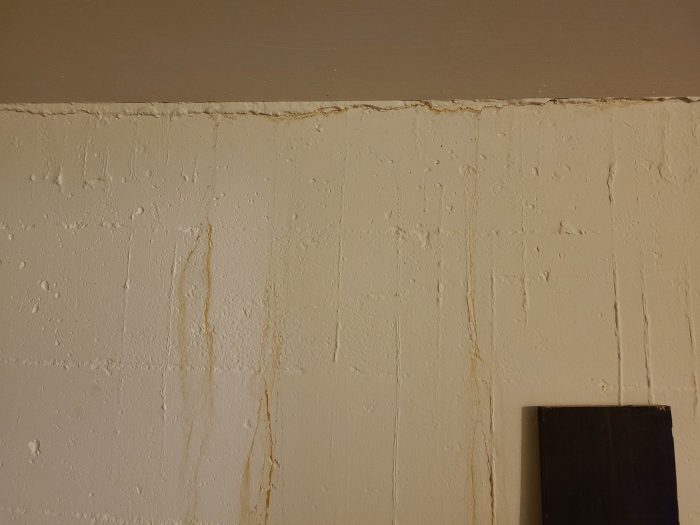

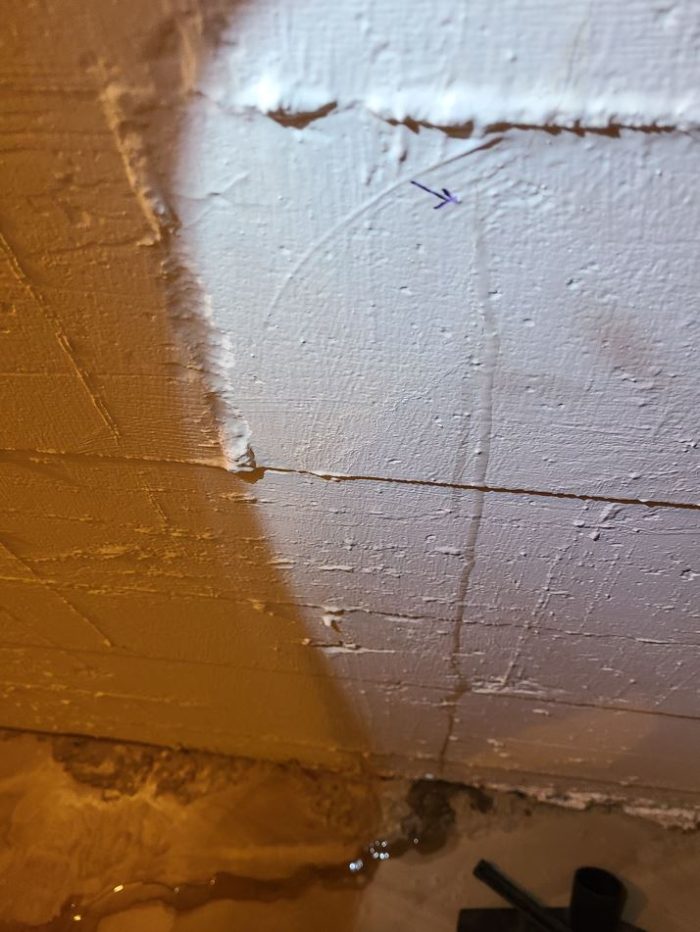

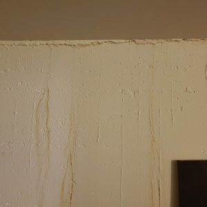

I'm pretty sure if a lot of moisture was moving through the wall/ceiling that paint will blow off in a hurry
Where is the moist air coming from if not through the walls/ceiling/floor?
There is a normal amount of moisture and then there is problematic amounts of moisture.
IF the roof was dumping bulk water onto the patio surface or ground water level was high I cannot see how the paint would stay on
Since the paint seems to be staying on it seems like it can be easily dealt with, where if it was peeling off, more extensive work might need to be done.
Moisture can come from moist air infiltrating. It can also come from moisture wicking from the ground, or in this case the ceiling, through the concrete via capillary action. There could also be liquid water leaking in when it rains.
I don't think we have a bulk water infiltration problem, because the humidity is about the same during the rainy season as it is now, when we've had no rain for several months. There is one tiny crack in the middle of the wall that leads to a small leak during very heavy rains, but we're talking about a cup of water total. And I don't know how to go about fixing that type of a crack.
The paint is staying on very well, I don't see any signs of peeling or loosening.
