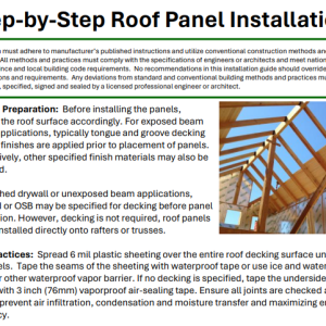

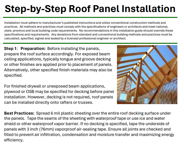

            If you use a product like RayCore (a "type" of SIP product & yes, foam) you may be able to skip the roof sheathing per RayCore's literature (see screenshot & attachment), but obviously you should consult & get approval by a licensed engineer & then get it OK by the building inspector (as it says in the fine details of their literature at the top).
            How?
            You would take one of their roof panels that has a structural element going all the way thru it (2X4 or 2X6) & mechanically fasten that to the Glulam rafters that are 12"oc.- I'm thinking these in essence would become your roof purlins tying the roof structure together.
            Then cover the Raycore panel with an approved membrane, strap them, add sheathing & metal roof (per manufacturers guide)...
            Just a thought - hope it may help!

          I have explored the Rayco panels and even spoke to their tech department who was very helpful. These panels use a closed cell foam. They will not allow vapor to escape should it accumulate at the ridge. These also do nothing for thermal bridging. In the early stages of design we thought we wanted to use SIPs or these Raycore panels. Mainly cost, as well as moisture issues steered us away.
