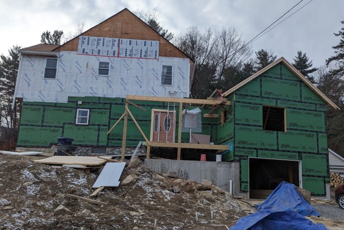

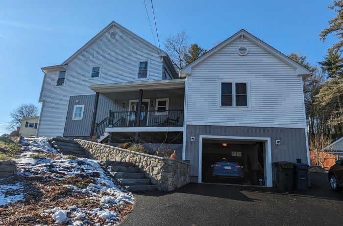

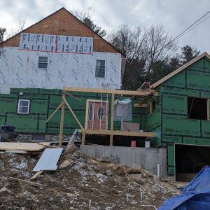

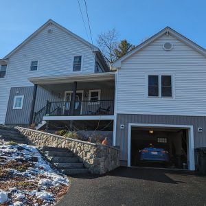

Sharing a couple of photos. Also I did review our bills. Heating cost came down but we will see the real impact once we get to February 2024. That is because our envelope upgrade was at around 50% complete in January and is probably at only 80% now since we didn't yet touch the corner of the house next to our front door.
First photo is a front view of the house a few weeks ago. You can see that we have one R30+ wall on the south of the house, this is the laundry room with an extra 1" foam covering up Zip r-6. That is not necessary for wall insulation but the added thickness was needed to cover up the sill and make it consistent all the way around the building. Rest of the wall you see (south wall on left side) is just a standard 4" cavity wall (using old school 2x4 studs) that had board sheathing. Added on top of those boards is Zip R-6 (which includes 1 inch of poly iso) which acts as our air barrier. Most of the effort went into the overhangs which were insulated with 3" of closed cell spray foam after 2" poly was inserted into the rafter bays, so this is an additional R20 or so on in place of what was ineffective leaky fiberglass. After this was done rock wool was added just to fill up empty space before the overhangs were boarded up.
The second photo shows the rear of the house during the installation of Vycor Env-S. There is a great video that I played for my contractors before installation on the Ana White Youtube channel; she and her husband installed the product on a new home in Alaska. You can see the fiber-faced polyiso that I got second hand from insulationdepot.com on the left side of photo #2. I covered all of the penetrations and dings in the material with little squares of zip tape. (This is a very important step IMHO because the screws embedded in the wind-lock plastic washers would be exposed to the air otherwise, and would transmit more heat through the wall.) We overlapped the corner of the house around 8". There is already zip tape under the corner.
