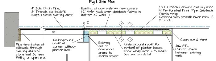

Fig 1 is a site plan showing the entire run. Water collected in the French drain will spill onto the sidewalk, just as the neighbor’s concrete driveway does. The lot drops about 8 feet from its high side to the street, so following that slope should provide effective drainage.

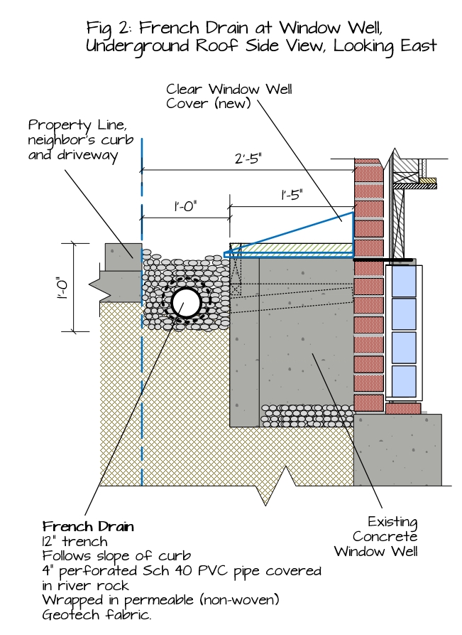

Fig 2 is a side view showing the plan for the French drain at the window well.

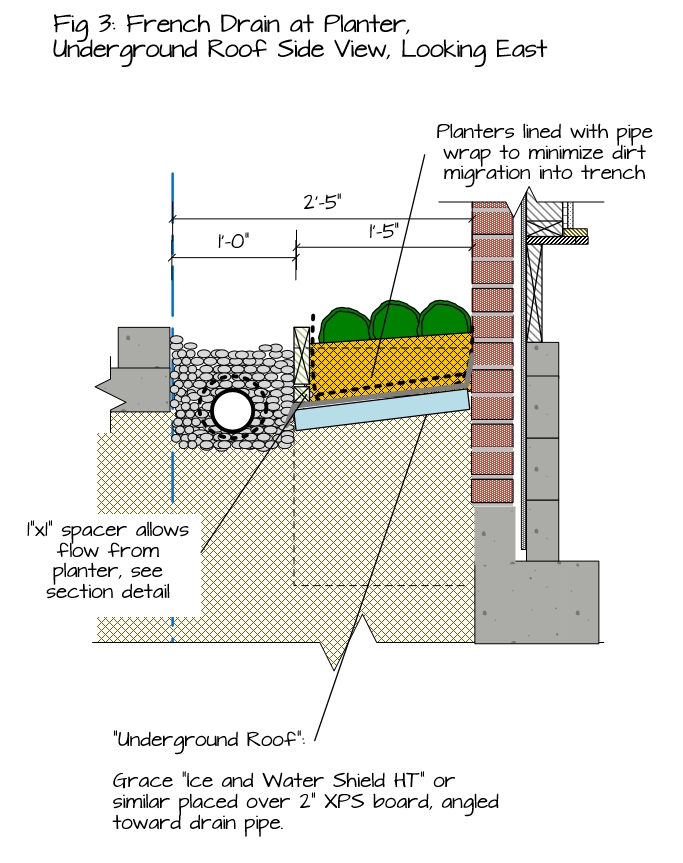

Fig 3 is a side view showing the the plan for the French drain at the planters between the window wells.
I wonder if the underground roof will trap a significant amount moisture that will surely be present at the outside of foundation wall despite all this, and lead to problems with the Polyiso sprayed-on insulation or elsewhere?
Comments, suggestions, questions are welcome.
  1. freyr_design | | #1
    Basements don’t dry to dirt. If you aren’t willing to fully dig out exterior and apply appropriate waterproofing then your best bet is an interior dimple mat with interior French drain.
    This in conjunction with underground roof
