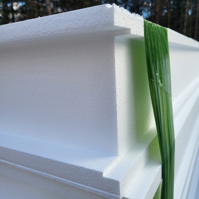

I cannot say that I was lied to in any material way, but I can say that things do not feel right to me. When I did complain, I received excuse after excuse. For example, when we received our product from Thermobuilt, I and several others on site felt there were issues with the way the product was cut for installation. The channels in the foam had several off-sets that, in my opinion, caused the surface of both the internal and external walls to shift. The excuse that made it even after I sent pictures was that it was due to the swelling of wood that got wet. I measured the width of the bottom plates and they were right on the mark, Then I was told that these even with the offsets were within tolerances. I have no idea what the tolerances are supposed to be? So when I complained further, i was told that I should be able to handle it with a hot wire or a rasp. Well, we tried, and in my experience, it takes hours, especially when so many were not even. I asked for some consideration in price because of these and some other related issues and was told no.

Thx for the vid. Thermobuilt panels are foam insulation that fits between 24oc studs. The chases are at the bottom of the panels at plug height. The lack of osb on the inside introduces many issues. e.g., difficulty attaching dry wall and previously mentioned electrical issues. I should also mention this a house built on a slab.
Sounds like you're in a tough situation. To be clear, Thermobuiult is not a SIP system. It's prefab EPS foam chunks that fit between studs and rafters, which requires conventional framing done with a high degree of precision and an electrician willing to work around the stuff. I imagine it would be a challenging custom build even for a pro. I hope you're able to find your way through.
