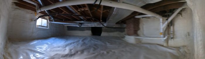

We had our basement encapsulated in the fall last year and made it through winter no issues. They used a thick mil high quality (apparently) vapor barrier and then sprayed /fogged with mold preventative. I don’t think there is any more mold – smell is not musty really and I don’t get a mold allergy reaction.
We live in a 50 year old brick ranch in Atlanta GA. Now since Spring we are smelling this bad smell. It is making me sick I believe. It smells a bit like cat urine type smell….. I have tried air cleaner, odor remover etc. with no luck. Basement is dry and at 40 percent humidity so dry. I have a dehu running as needed down there. Our furnace/AC and gas water heater are all in the crawl space as well. So we have those venting out I am hoping the smell eventually dissipates but so far it is strong and we smell it in the living space when the AC runs. A subtle yet bad smell. What to do??? I spent a lot on the encap. Didn’t anticipate this bad chemical-cat urine-odd smell.
I am worried it is toxic. I don’t know how to proceed. Recently had ducts professionally cleaned. Have had 2 HVAC guys checking duct connections and AC. Everything normal they say. Except the strong smell. I am pretty disparate for a solution. The crawlspace guy who did the encap said he never had any complaints about a smell….except early on he got one and he changed the material used afterwards.

In my opinion, you may simply need to ventilate the area (install an air exchanger or place a fan in a window) for a while and see if that makes a difference now that the area is sealed tightly. Plastics in general emit some nasty by-products which need to be ventilated to the outside of the building. If this does not work you can order an air quality test to see if you have mold and also to check what level your total volatile organic compounds are at. Should the test come back as unacceptable (red zone), you may need to bring in an environmental engineer to find a solution for you. Typically ventilation will correct your problem. You may also consider testing the home for radon while your at it. Radon suction ports installed below the membrane will also eject emitting odors to the outdoors.

I would suggest finding out what material the vapor barrier is and what sealant was used. For example, vinyl sheets can be smelly as can Tremco acoustic sealant. Polyethylene as a barrier tends to be less smelly, and Contega HF is a sealant that is much less smelly to start and that stops smelling much faster (within hours).
To figure out where the smell is coming from, take a sample of each proposed or existing material, and put it in a glass jar with a tight lid for a few days. Then open the jar and smell it.
Polyethylene is the most common vapor barrier material, and I have yet to hear of anyone finding it smelly. Perhaps a bad batch? You can buy a small package of poly sheeting at a hardware or home store for under $5 and test it to see if it has the same problem for you. If you did find that to be a problem, another inexpensive plastic sheet material that is low smell/taste/toxicity/outgassing is polypropylene. It's harder to find in big rolls of the kind of thickness you'd want, but you could probably find something you could use. Another option might be radiant barrier foil, which is Al foil laminated to a reinforcing scrim. Foil is highly impermeable, so would block any smell from underneath it, and although I don't know what scrim material and adhesive are used, it would probably seal in any smell that might result from that. It would be more expensive than polypropylene, but might be easier to find.

I am experiencing the same issue of a cat urine smell in my encapsulated crawl space in the Atlanta area. I started by contacting the installer, which contacted the manufacturer of the polyscrim material used as the vapour barrier. No luck there... The manufacturer said they didn't have issues and said its more than likely off gassing of the soil.
As a temporary solution I opened up 2 of my crawl space vents tand instaledl vent fans to get some air movement. It helped a little, but still not happy with it. Especially since I opened the envelope to my encapsulation.
I also have a SanteFe Max Dry Dual XT dehumidifier running all of the time.
So the next step I guess is the radon system under the vapor barrier. Anyone install the radon system and successfully remove the "cat urine" smell??

I had the same problem. I had a cat pee smell (ammonia like) in my crawl space. Why I chose to encapsulate my crawl space with that smell is beyond me. I was told it my vapor barrier but that wasn't the case. The cause was my soil, apparently from decomposing plants. The science is a little bit over me but this article I found describes it. https://crawlspacerepair.com/blog/Cat-Pee-Smell-In-The-Crawl-Space
I was able to get rid of the smell by balancing the soil. The PH range goes 0-14 with 7 being neutral. I tested the soil and was at a 11 PH. I was able to get to a 7 PH and I no longer have that cat urine smell. Unfortunately, I had to replace my vapor barriers but that was my fault. Again, if you have this smell in your crawl space, don't encapsulate it first or you'll get that smell on your vapor barriers. They don't cause the smell, but they retain it for sure. Solved my problem though. Hope it helps.

Sean, sulphur reduces soil pH. You can get it at farm supply stores. You wouldn't think "sulphur" and "neutralize smell" as being complementary, but that's how it works. Here's one source: https://www.fedcoseeds.com/ogs/search?item=8249.

It's the liner. Cheaper vapor barriers will give off a cat urine smell.
