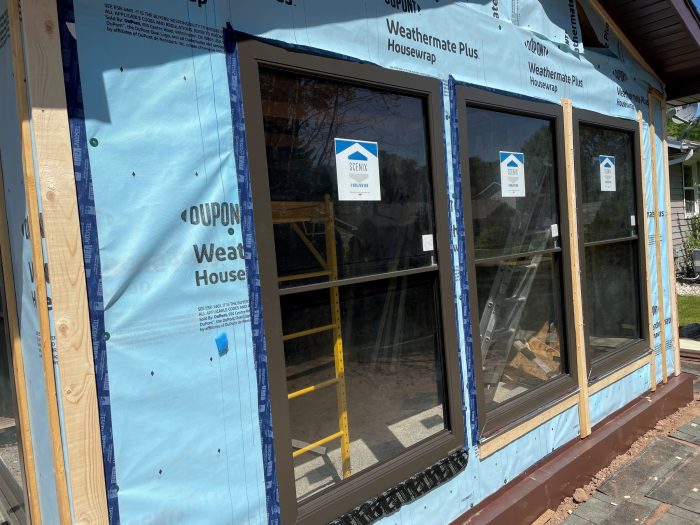

On our project, we mostly copied Hammer and Hand details for our wall assembly, including the rainscreen set-up: https://hammerandhand.com/best-practices/manual/4-rain-screens/4-6-horizontal-rain-screen-battens-vertical-siding/
Steve Baczek had a slightly different idea for this area, with the Cor-A-Vent installed between the top of the siding and the frieze board (if my memory is correct). I did a quick online search, but I couldn't find the detail. I'm pretty sure it showed up here on GBA or in Fine Homebuilding magazine.
Although we haven't had any issues (I keep looking), with our assembly insects could (at least in theory) set-up a nest on the blocking behind our frieze board. With the Baczek detail you completely deny insects any entry point to this top of the wall area. Either way, there should be ample air flow behind the siding.

Ventilated rainscreen details for the gable ends are basically the same as the rest of the house, you're just following the angle of the roof. I'll attach a couple of pictures from our project showing a gable end before blocking/frieze board are installed and after.
