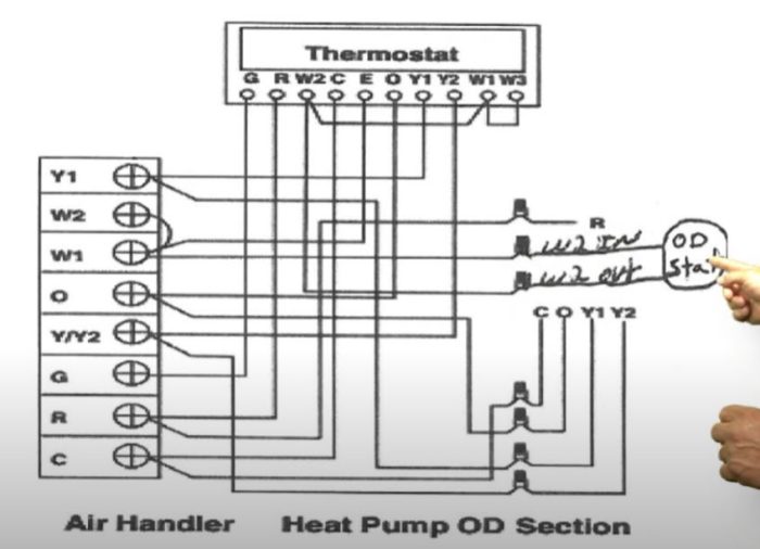

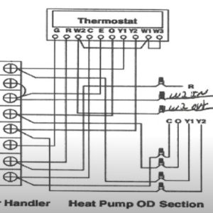

    Every brand has an interface to the antiquated multi wired universal interface with one wire for each function low heat, high heat low cool, high cool, fan and so on. Something like this photo is required.
    Each brand has also developed a proprietary communicating interface with 3 or 4 simple wires to replace the rat’s nest but all the equipment must be from that brand and have the communicating feature.
    Without some secret inside information hacking communicating system seems very unlikely.

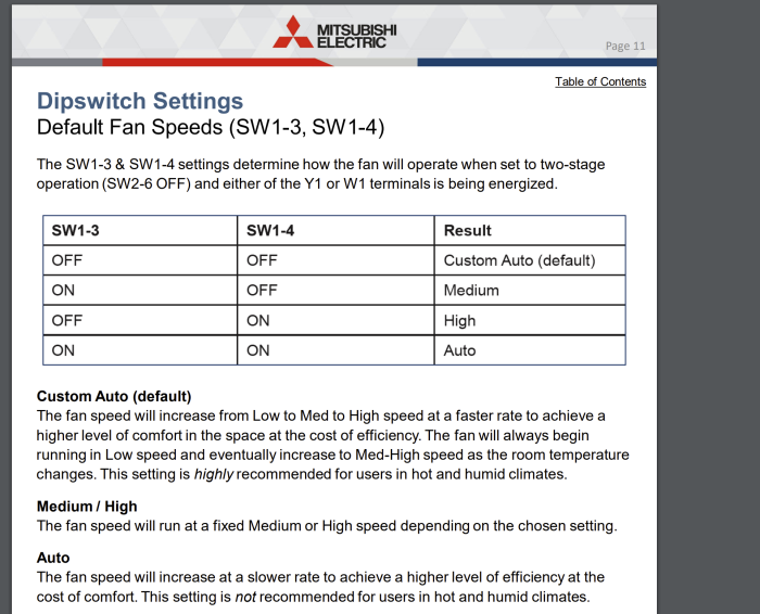

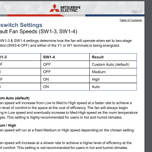

    Here is the the sequence of operation for the thermostat interface. The fans can run in auto and vary speed according to demand (see attached image). There are a couple dipswitches that change the behavior. https://mylinkdrive.com/viewPdf?srcUrl=http://s3.amazonaws.com/enter.mehvac.com/DAMRoot/Original/10006\Application_Note_3062_ME_-_Thermostat_Interface_2_Sequence_of_Operations.pdf
    Install guide: Shows wiring to conventional old school stat (ie. Nest/Ecobee).
    https://mylinkdrive.com/viewPdf?srcUrl=http://s3.amazonaws.com/enter.mehvac.com/DAMRoot/Original/10007\PAC-US445CN-1%20Installation%20Manual.pdf
    1. Izzza | | #8
      Thanks, I am not smart enough to understand what this means.
      I just looked into it a bit more, and it seems more complicated than just “variable speed” as the heat pump is VRF which I don’t fully understand. What is clear, however, is that Mitsu has propriety communication controls in order to get the full functionality and efficiency of the VRF. I don’t know why we even got this fancy heat pump, what a nightmare. I would really love to use something like an EcoBee, but it seems to defeat the purpose of such an expensive heat pump and we could have just gotten something much cheaper that could work with normal smart thermostats. The issue is also that I am not an engineer and would not be able to hack something myself, so it is up to the installer or our engineer and I don’t think they have a clue. The options seem to be get the horrendous Mitsu Kumo, or keep the archaic standard controller.
