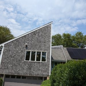

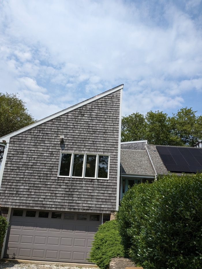

    I have a "modern" house built in the 1970's in Rhode Island, one wing has a shed roof. See attached. I think it's about 10:12.
    There's a couple of problems from a buildability perspective. First, there aren't standard flashings or treatments for the upper edge of a shed roof, the builder has to improvise a termination. It's really hard to ventilate properly, there isn't room at the ridge for a vent. I don't like not having an overhang on a roof -- that's also a problem on the side facing the camera.
    As you mentioned, it creates a big tall wall. If you look at the vernacular architecture of New England such walls are rare, they're usually broken up with a skirt of some sort between floors. The reason is that big vertical expanses tend to leak in a driven rain. Not having an overhang makes it worse. This wall as originally constructed leaked quite a bit, we had it redone with 21st-century WRB and flashings, and it still leaks a little when conditions are right.

      There is a 24" overhang on the lower edge, it wasn't original to the house but was added when we re-roofed.

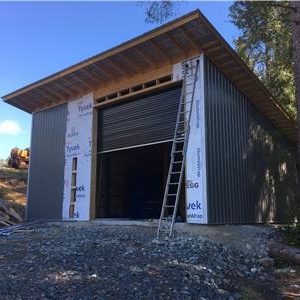

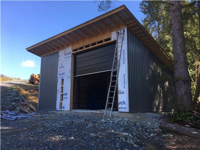

    Just like a gabled roof, the minimum slope is best kept at 3/12 or higher. I've done a bunch of them. Sheds, workshops and houses.
    Think through how you intend to insulate before going too far. That may influence how deep you spec the trusses.
    You don't have to have cathedral ceilings in every room. A variety of ceilings heights can allow for loft spaces, and also enclosed areas for mechanicals between the ceiling and roof.
    As long as you have overhangs, the detailing of the flashing and ventilation is pretty straightforward.

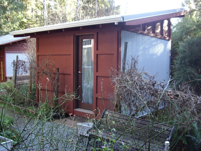

    A shed, a workshop, a house:

        I was working in that center shop last week in heavy rain (enough to fill the 1000 Imp. gallon tank fed by the gutter in one day) with the door rolled up, and the ground didn't get wet within about 16" of the walls.

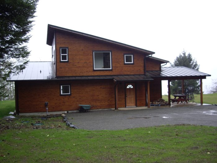

    I call them mono-pitch or mono-slope roofs, mainly because "shed roof" sounds cheap. I have designed and/or built a few of them, including this one I designed that is just about complete now: https://www.instagram.com/p/CwlZV1IrL2Z/?img_index=1, https://www.instagram.com/p/C0wUad-rUOo/. They work well in specific situations but some of the detailing is challenging, and if you want two stories it's usually more efficient to build a gable roof.

        Michael Maines | | #16
        It's a 4:12 roof. Here in snow country I don't like to go less than that with a shingled roof, and this project had a very tight budget so we couldn't do a metal or membrane roof.
        Perhaps the most challenging detail is client management! I had designed it as a single slope across the whole building, with a small areas on the high side carved out for a bedroom, bathroom and small yoga space. When my client saw the yoga space, she wanted to raise the already-framed roof. She got more space and loves that room, but ultimately couldn't really afford it.
        Dealing with what happens at the high side can be tricky. The spans are fairly long so we used I-joists. It has R-60 dense-packed cellulose with a 1 1/2" vent.
        This has a slab foundation over Glavel, the first time I used that detail.
          DCcontrarian | | #18
          Where do you put the vent on the high side? In the roof or in the soffit?
            Michael Maines | | #20
            This is vaulted all the way to the peak, so the roof vents into the soffit space. We used Coravent vents directly behind the fascia where they aren't very visible. In fact the insulators wanted to know why they were installing Accuvents without eave and soffit venting!

      There is nothing wrong with it. It is included as one of the five common roof assemblies we know work in Martin's article: https://www.greenbuildingadvisor.com/article/five-cathedral-ceilings-that-work

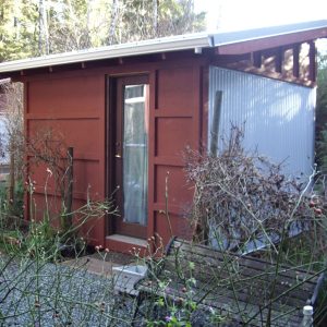

      I used it on the backyard studio I built this summer in the attached photo. Compared to the much simpler assembly #1, it is expensive, harder to build, detail and sequence - and as we have discussed in your floor assembly thread, relies on good weather to install.

        That looks really good Malcolm! Thanks for sharing the images. It's nice to see the rafter in the first image which better explains the rafter tails to me. In the second, it looked like they were scabbed on.
        Anyway, mine is similar (as you likely gathered :)).
        1. Malcolm_Taylor | | #28
          Tiziano,
          Attaching that last rafter outboard of the sheathing makes the detailing a lot easier, both at the corner, and at the top of the siding.
          Disclaimer: The client insisted on the colours.
