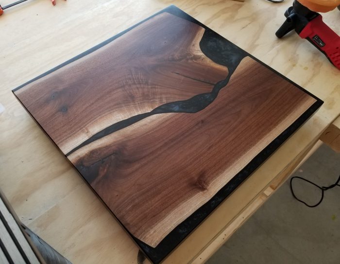

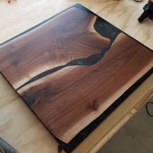

If you pursue epoxy, this product I've found works the best (as with all 2-part epoxy products, you really need to follow the instructions): https://www.superepoxysystems.com/liquid-glass-epoxy/
It doesn't have much smell during application.
The tung oil, or the hard wax oil finishes, will give you a more natural looking finish.
