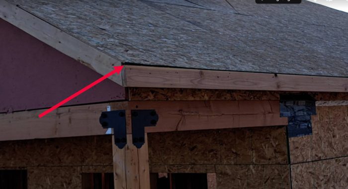

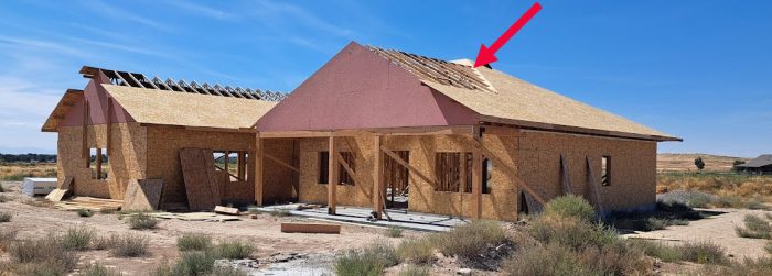

Our framer is about done with the sheathing on our roof.  Is there a building code section that covers gaps in sheathing or can they call it cosmetic and charge me to fix it?
1. Where the sheathing meets the sub-fascia we have some bulges (see “Bulge” image below for one example).  Is there a code?

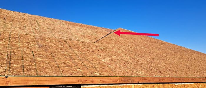

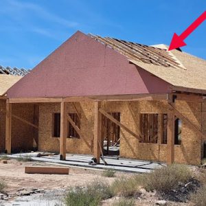

2.  Where the over-build for the patio roof meets the trusses for the main part of the house we have a gap. It looks like it’s from where the underlying framing comes together (see image “Gap” below.  Is there a code for that area?

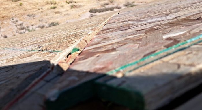

      That roof line with the seams not being offset actually looks like framing coming through from the bottom See picture. I've never seen this type of gap before and it feels like it should even exist.
      1. Malcolm_Taylor | | #4
        idahobuild,
        It's very confusing, as if all that roof is in the same plane there should be no diagonal joint in the sheathing at all. I suspect it is done that way to cover a defect in the roof framing below, although it's hard to tell from the pictures. The lack of offset sheets is worrying too.
        I'm not too concerned with the bulge at the eaves. It will largely disappear once the drip edge is installed.

    The bulge at the eave looks to me like the gable-end truss or framing is higher than the field trusses; it will be disguised once the finishes go on, but I hate to have that large a discrepancy on a new build. From what I can see it will perform just fine; the dripedge will cover the gap.
    It's hard to tell what's going on with the diagonal gap. Could you get it from other angles, preferably showing more of the roof? In any case it's not normal and may indicate a problem.
    Edit: the photo in your other thread on the same topic is much more clear. (You should really only have one post on each topic.) It looks like a sloppily sheathed hipped roof with an overlay roof attempting to plane in with the main roof, with poorly done angle cuts. I doubt it would cause any significant problems but it might telegraph through the roofing, and some of the roofing nails are likely to hit air instead of sheathing.

      I feel the same about the bulge at the eave; that it will be covered but why not have it correct. In its current state, the drip edge installer will have to do his best to 'cover it up'.

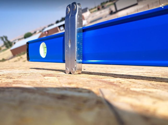

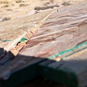

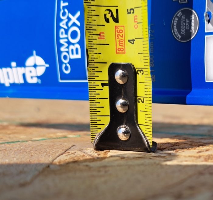

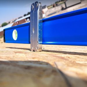

      The really bothersome part is "the sloppily sheathed hipped roof...with poorly done angle cuts' (Michael M). In different places it is anywhere from 1/2" to 3/4" out of plain. So, I am thinking there will be issues with securing the roofing and the roof material's ability to mask the elevation change. We are 'supposed' to get a standing seam metal roof.
      I also found an area just below the gap that has a 1" depression from the surrounding sheathing.
      Is there a IRC or other code element that covers out of plain joints in roof sheathing and one for bulges and depressions.
      See images attached.

          Thank Malcolm - I brought it up early last week and the site super said it was on a hip part of the roof and would be covered by a cap. When I went out to the site later in the week I confirmed that it clearly isn't on a Hip portion of the roof. Well, I guess there is a hip under there but it is under the overlay from the porch gable.

    Check the installation guides for your metal roof panels. Most will have something along these lines:
    The substrate must be no more than ¼" (6.4 mm) in 10' (3 m) out of plane in any direction. Adjacent decking shall not be more than ⅛" (3.2 mm) out of plane. Out of specified plane areas will need corrective action prior to proceeding
    That step will need to be shimmed flat for the roof to be flat. This can be done with the metal panels or the deck. Some seamed roof panels can come with adjustable clips which might be easier at this point.
    I would not accept that much out of plane on a new build. The gap at the soffit is normal, happens all the time, 1/4" is precision framing after all.

    The GC had the framer come out with the truss company and fix some trusses. That action fixed where the gable meetsthe hip.

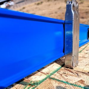

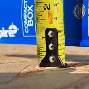

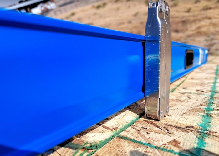

    However, the roof sheeting is still out of plane in one area (see atch'd pic) and the Super is saying it's fine. It is clearly out of plane visually. It is impossible to see in pictures. One roofing company has already said they couldn't install metal roof on it.
    Does anyone know of a standard for this besides the " shall not bow more than 1/2" in 2' " NAHB standard the Micheal M provided above?
    I guees out of plane is similar to "bow".
