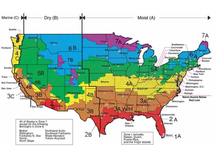

>"We are in the bay area 1 mile between climate zone 3 and 4.
CA state climate zone numbers have no correlation to IECC climate zones, though in this case they are similar enough to be confusing. Most of the SF Bay area is within IECC climate zone 3C (marine) though parts of the east bay are zone 3B (dry). See:
https://s3.amazonaws.com/greenbuildingadvisor.s3.tauntoncloud.com/app/uploads/2018/07/25030612/H-T%20Zones%20with%20Cities%20ABC%2B_0-700x525.jpg
Compare that to the CA climate zone map used by CA building codes:
https://www.title24express.com/s/cc_images/cache_2599443704.png?t=1331164014
In IECC zones 3B or 3C it's safe to use (cheaper and more environmentally friendly) open cell foam rather than closed cell foam directly on the underside of the roof deck. In the wetter more foggy 3C side it may be beneficial to use a "smart" vapor retarder on the interior facing side of the foam to limit moisture transfer rates which in some cases may result in rapid swings in attic air humidity levels over the course of a day- an issue much more common in the eastern "-A" climate zones. At 5" or more of depth it probably won't much matter in zone 3C.
