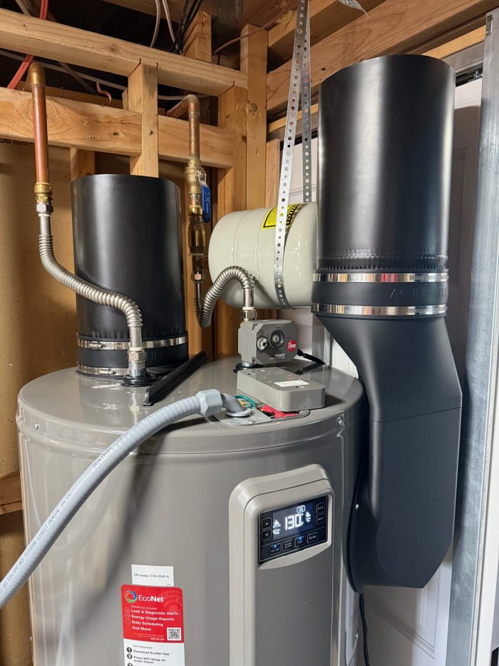

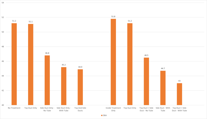

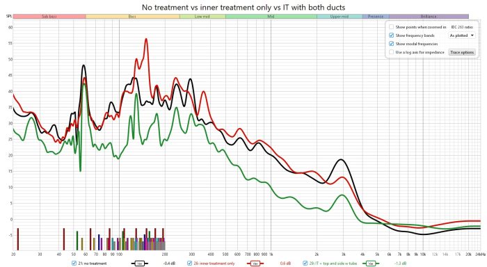

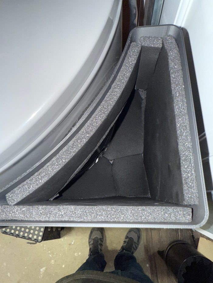

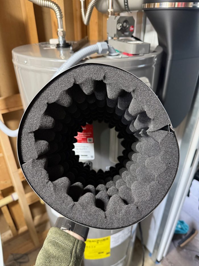

I did some pretty extensive research on the sound problem and was able to reduce it somewhat. I posted a PDF of my saga at
https://drive.google.com/file/d/15AbxYCowloRsAuCNfjPAZcDhmtOyJINC/view?usp=sharing

The insulation looks identical to what tgtech reported on his amazing document.
BUT there is an added piece of molded rigid styrofoam in between the casing and the compressor. The same type of styrofoam from those single use coolers.
The noise wasn't so bad, I would have left it as is, but I did order some Kilmat and some foam eggcrate sound proofing (similar to: https://www.amazon.com/Upgraded-Self-adhesive-Sound-Proof-Panels/dp/B09Q8JFBX7/ref=sr_1_7?crid=237RE7J1L9JUV&keywords=sound+proof+foam&qid=1668447617&sprefix=sound+proof+foam%2Caps%2C104&sr=8-7)
So I did line the interior of the enclosure with one layer of Kilmat and then added the foam where I could without tampering with the airflow and touching the heat pump exposed "plumbing".

After I get the permit signed off, I will try some noise mitigation efforts similar to those of tgtech and maybe call Rheem.

A very interesting article to mitigate Rheem HPWH Noise:
https://www.paloaltoonline.com/blogs/p/2022/05/22/what-to-do-if-you-get-a-noisy-rheemruud-heat-pump-water-heater
Read the "Update!"... 3 layers of MLV... very tempting to try.
Great article! Unfortunately, much as I want to believe there's such a simple fix, I'm very skeptical that 3 layers of mass-loaded vinyl will reduce the noise to 48 dB.
If you look at the photo, they wrapped MLV around the side of the compressor area, but there's nothing to stop sound from going straight up -- which others have pointed out is the loudest direction -- or outward in the direction of the exhaust vent. Sound radiates in all directions and flows like water.
Even if the compressor emitted no sound from the side walls of the water heater, I measure 64 dB coming straight out of the exhaust vent on my unit. (And yes, I've replaced the fan already.) The MLV will do nothing to stop that sound. At minimum, I'd also suggest putting insulated flex duct on both the intake and outtake to try to block at least a little of the noise. I already have a duct on the exhaust, and at best it reduces the noise to 60-62 dB.
My skepticism is based on my own experience hiring professionals to do soundproofing using MLV, QuietRock drywall, Safe and Sound mineral wool insulation, and Green Glue. I hired them to soundproof an outdoor heat pump compressor near our bedroom. The outdoor unit is only 55 dB -- much quieter than the Rheem water heater that's inside the walls of our house. I have some leftover MLV from that project that I could strap on exactly like in the picture, if only to rule out the possibility that it miraculously works.
I really do want to believe! If anyone finds a magical solution and verifies it, please share.

After almost 3 months, 5 shipments from Rheem, 2 sets of noise material, and tearing the unit apart 4 times, I have an average of 48 dB at 3 feet. Rheem Gen 5 50 gal hybrid, installed in basement on concrete floor, in Maine.
1. Initial noise – 67 dB. I installed outlet ducting to outside because basement was so cold. Noise reduced to 63 dB. Could be heard on 2nd floor, a whine.
2. I called Rheem and they sent me a new fan. I asked if there was anything else they said no. I installed the fan and my own soundproofing inside the top and sides, and in the coils cavity. 57 dB.
3. After reinstall, I kept getting A129 top element relay not closing and T009 compressor wiring problem. After many calls to Rheem, I got new elements (not needed, but installed, and then a new circuit board. Errors cleared.
4. I called Rheem again and they mentioned the noise kit (top and fan gasket). I had already done that with my material but took it anyway. They also sent me the 4 rubber feet for the unit (for wood floors). I figured what the heck, and installed them anyway on concrete (had to shorten my outlet duct 2 inches). Still 57 dB.
5. I asked then for the KELI fan (thank you @pinballwizard ). I tried to get Rheem to send me the inlet duct adapter since most of the noise was coming out there, but they would not under warranty. So I bought it from Menards and saved $100.
6. I installed the KELI fan. I could not fit up all 4 holes on the heater to the fan. Although the fan had many holes, I could only get screws into three holes. I put more sound material on the compressor floor, on top the compressor (allowing for air), and around the fan. I also put it on the inside of the plastic inlet and outlet adapters (only 1/8” thick), and on the insides of all the inlet ducting, and had the opening face a wall with sound proofing material on it, trying to catch as much inlet noise as I could.
7. Put it all together, turned it on, and heard a ThThThThThThThThTh sound coming from the fan. I thought it was some sound proofing hitting the blades. I wasn’t going to drain the tank remove all the ducting again and pull it out to fix it, so I cut away all the outlet grill work (not needed since I have outlet ducting), and found the fan blades were hitting the housing of the fan, due to the fan housing being slightly torqued with the 3 screws. I loosened one screw slightly and the sound went away. Whew. So caution on installed a KELI fan – be sure it turns easily before closing up.
8. Hooked up the ducting. Meter said 49dB. I couldn’t believe it. After running a while, it averaged 48dB. My wife couldn’t believe it was running. I have to go downstairs to see if it is.
9. BTW, got the errors again. Going to call Rheem Monday for a new control board again. I am very careful removing the 6 heavy leads to the relays, but something must break on the board when it is removed.
10. I’ll post some pictures later.

Here are pictures of some of the the noise work I did --
1. Floor of compressor
2. Compressor
3. inside coils cavity
4. KERI fan with insulation (note motor difference from stock)
5. Outlet adapter with one way valve beyond
Hello Bob777,
Just got my KELI fan from Rheem. I notice the wires are pinned differently than the stock fan. Did you have to repin your KELI fan connector? I have attached a pic of the KELI fan and its connector (w/ yellow ground wire?) next to the stock fan and its connector.
Thank You!
Finally installed the KELI fan and ended up connecting the yellow ground wire to a screw connecting the fan shroud to the unit. Tested the fan and its running great. Rheem provided a gasket kit to replace the top lid and fan gaskets. I also purchased the intake shroud and with all 3 changes I went from 70db to 64db one foot away from the unit.
Hi Bob-
Thank you for all of the pictures!
What sound control material(s) are you using? Source(s)?
https://www.amazon.com/uxcell-10-76sqft-Insulation-Silencer-Dampening/dp/B01KAD1ZPU?pd_rd_w=tWl4t&content-id=amzn1.sym.724fac2e-0491-4f7a-a10d-2221f9a8bc9a&pf_rd_p=724fac2e-0491-4f7a-a10d-2221f9
a8bc9a&pf_rd_r=KTXHCADTW67KXEWE67K8&pd_rd_wg=gDsr4&pd_rd_r=1c47d5d5-fbe2-4d59-b8aa-44aa740b215f&pd_rd_i=B01KAD1ZPU&psc=1&ref_=pd_bap_d_grid_rp_0_11_i
Thanks!
A few more pictures - I did a lot here since I thought a lot of sound was coming out the top.
1. Inlet adapter
2. Inlet duct opening
3. Inlet overall with opening facing wall with sound insulation on it.
4. Top shell insulation
Final ones
1. top cover insulation
2. piping showing dual operation
3. Final beauty shot in operation

PS - use flat washers over the supplied screws when putting on a Rheem outlet adapter -- the plastic can crack very easily when tightening the screws against the gasket. See picture 3 post #257.
I'd like to exhaust mine through the side of my house. Is it OK to reduce the duct down to a 4" penetration through the house?
Read the Rheem installation manual available on the HD site to see size and length options. 4 Inches is small --I used a 6" vent.

I opened it up for the soundproofing additions. Rheem updates since Feb 2022 -- 1. thin foam sound padding ring on fan connection to frame. 2. thin foam sound padding inside chamber between fan and coils. 3. heavy foam padding on top cover (same foam padding that comes with their sound kit). Surprisingly, they are still using the same crappy fan that I replaced – not the KELI fan.
So I swapped fans (the thin ground wire on the KELI I attached to a screw holding the coils to the frame), added all the same insulation I had done previously - source https://www.amazon.com/uxcell-10-76sqft-Insulation-Silencer-Dampening/dp/B01KAD1ZPU?pd_rd_w=tWl4t&content-id=amzn1.sym.724fac2e-0491-4f7a-a10d-2221f9a8bc9a&pf_rd_p=724fac2e-0491-4f7a-a10d-2221f9a8bc9a&pf_rd_r=KTXHCADTW67KXEWE67K8&pd_rd_wg=gDsr4&pd_rd_r=1c47d5d5-fbe2-4d59-b8aa-44aa740b215f&pd_rd_i=B01KAD1ZPU&psc=1&ref_=pd_bap_d_grid_rp_0_11_i Padding on the inside of the top cylinder, the top cover anywhere metal was showing, more inside the chamber before the fan, on the floor of the compressor area, inside the Styrofoam piece around the fan. I had to really force the top cylinder into place with all the sound padding as well as the top cover.
Results --- Ta Da – 49 dB at 3 ft and no more alarms!.
