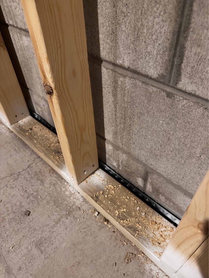

I’m in the process of finishing my basement, and trying to figure out if I should remove poly sheeting before adding insulation. I currently have 6mill poly sheeting running from sill plate down to a drain tile in the floor around the entire basement, similar to the attached photo except no stud wall built yet. Purpose of the poly is to channel water down wall and into drain tile. I’m planning to insulate according to the https://www.buildingscience.com/documents/information-sheets/basement-insulation article, but it makes clear that “No interior vapor barrier” should be used to allow for drying to the inside.
I’ve got 2″ xps that’s ready to install over the poly, but thinking I should remove the poly sheeting first. Will I have issues if I leave the poly up? Seems like the interior surface of the XPS should be warm enough to avoid condensation. I’m in NY climate zone 5.

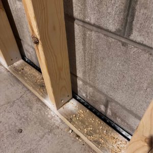

Thanks for your insightful replies! Your comments and the linked documents support my design and give me some assurance I'll be successful. In the 10 years I've lived in this house, I've only had small amounts water coming through the walls (weeping) twice and both were due to clogged gutters in a downpour. I'm now better maintain the gutters, but as a precaution I installed a drain tile and the poly as part of finishing the space since I was replacing the basement floor anyway.
I've attached my wall assembly plan below and some in-process build pics in case others are looking for a similar solution. All XPS joints will get taped or caulked, and the interior wall cavities will not be insulated.
