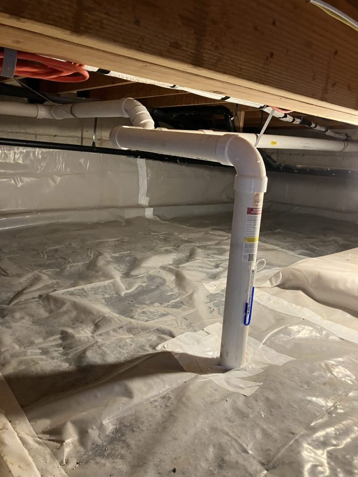

Dear GBA friends,
I just finished reading “All about Radon” with the comments as well as a few other articles. Thank you for the advice.
I wonder if my situation would have been less problematic with a vented crawlspace rather than conditioned. Anyway I have an unvented crawl now. House has been built over the last 5 years, and I moved in 2 months ago.
I installed a 10 mil vapor barrier, taped at seams, sealed to concrete stem wall with adhesive and pins (https://crawlspacerepair.com/crawl-space-foundation-pins) at least 12 inches up. Under the plastic I laid down landscape fabric to protect the plastic from the 3″ round rock. There are about 4-6 inches of this round rock throughout the crawlspace.
Obviously there are no vents in the crawlspace wall to the exterior. I have 3 vents between house & crawlspace and was about to install fans (with inline carbon filters for minor smell) for intermittent air circulation. Crawlspace temps are about 55 degrees F and humidity in the 70% range. Would be good to get it closer to the house which is 65 F and generally 55-50% humidity.
I’d hesitated to install the air circulation due to the minor but noticeable smell, ordered the carbon filters from ac infinity. Then thought of testing for radon.
Radon in the crawlspace comes back at 24.4 pci/L (2 bottle short term tests https://www.prolabinc.com/radon-gas-test-kit/). Tested the interior of home and results are 10.5 pci/L (average of 2 bottles).
So. This is high, but crawlspace (I’m ashamed to admit) has been unvented for quite some time (although it has the liner). During dry summer months I’ve often run fans and generally aired it out some.
So I’m living in a house with 10 pci/L. I have contacted two remediation companies, first one quoted me $5700 which seems high (no visit to my site). So I’m waiting on a 2nd company and a site visit this week.
Is it worth doing a 3 month test right now, or should I move straight into investing in remediation?
Question 1
Is it responsible or irresponsible to wait for 3 month test results before acting/remediating? I am living in this space already.
I have ordered the 3 month test from prolab. I can also pick up a 2nd short term test but at this point i have 4 bottles confirming my levels are elevated so perhaps it’s a non issue.
Any money I throw at this seems cheaper than lung cancer. At the same time I don’t want to panic and waste money.
I am likely to proceed with remediation, and I would LOVE to be able to resolve my issues with a passive system. I do not have an attic, so I eagerly await the conversation with the remediation contractor (https://cascaderadon.com/ of portland OR) regarding the specifics of whether this can work. I think adding a fan if passive is insufficient seems doable as a follow up.
Question 2
I did read about the HRV in the crawl as another possible approach. Should I add that to the mix or just start with a passive system? How do I think about HRV conjunction with remediation. I did a blower door test a while ago and we concluded that my house is not quite air tight enough to recommend using an HRV system.
Question 3
I think the 10 mil plastic I have now is already sturdy enough to be used for the depressurization system. But one company specificed 12 mil plastic, a special type. Opinions on that? If I use what I have now I forsee the contractors cutting holes in it to install the pipe, then re-sealing the cuts.
Question 4
type of pipe for depressurization system. I used sched 40 perf pipe around the outside of my foundation for foundation drains. For the radon system, first contractor said perforated schedule 40 pipe. 2nd contractor said socked ADS pipe, which doesn’t sound as strong. Strong opinions on these options?
Question 5
I have a centrally located utility closet, but the question of how to get a pipe up & out of the house with minimal turns seems tricky, and I hate to cut holes in the roof. Run a pipe up an interior wall and then exit high in the wall? (it becomes an exterior wall further up) I might have to show drawings to make this make sense.
Thank you all, I’ll keep you posted and watch this space for replies.

I wouldn't count on an HRV as the primary method of radon reduction. I'd rather get it out of the house before it enters the crawlspace air (and house air since they are connected). The 10 mil plastic should be fine if it's in good condition; I don't see any reason to replace that. Either type of pipe should be ok as well. If it is difficult/expensive to get a pipe up through the roof, then you could go right to an active system with an exit out through the rim joist.
I think you're going to need an active system with your levels -- a passive system is probably not going to be enough. I also think you should go ahead with the remediation system installation now, and not wait on a 3 month test. Your levels are very high, so I doubt very much another test is going to show enough difference to get you into the safe (>4 pci/L) level.
I had a somewhat similar situation to you, where I tested my crawlspace prior to encapsulation. My test results (using a lab test) were around 8.1 pCi/L. I put in an active system using the existing footing drain by sealing the sump pump and coring the basement slab to tie into the drain. I'm not consistently down under 1 pCi/L, usually much less (0.2-0.3 pCi/L is typical), even though I haven't finished the encapsulation project yet so the vapor barrier hasn't been laid down. My plan is to run some perforated corrugated pipe around the perimeter under the membrane so that the crawlspace becomes a second "zone" for the radon system, and I have the radon fan plumbed for this already.
The pipe doesn't need to be particularly strong, since it isn't going to be taking any real load. The radon fan is going to pull maybe a few inches of water column worth of negative pressure at maximum, which isn't enough to collapse any type of drain pipe you're likely to try using here. The corrugated stuff is easy and fast to install, and is also cheap, which is why I'm using that. All you need to do is to depressurize the earth underneath the vapor barrier, so you don't need anything fancy. I'm just running a loop of 3" pipe around the footing in a C shape on the outside wall away from the connected basement, since that area is already covered by the "primary zone" for the radon system.
Regarding your specific other questions:
1- See above
2- I'm not a fan of using an HRV for this, since it is a sort of bandaid, exhausting the radon once it has already entered your home. Using an actual radon mitigation system collects and exhausts the radon BEFORE it enters your home. It does this by depressurizing the ground beneath your home, which is a bit like using a big vacuum cleaner to suck out the radon before it enters your home through the foundation walls and slab.
3- Thicker is better, but mostly for durability -- even thin stuff will work fine as an air/vapor barrier. I like to use 20 mil on the floor to minimize the possibility of damage in the future when doing any work in the crawlspace. I use a reinforced 20 mil crawlspace liner for this, and thinner material on the walls where the material is less likely to be damaged (this saves some money). 10 mil is the minimum. 12 mil would be better. 20 mil is the thickest commonly used. Thicker is better, but costs more money. Reinforced liners are less likely to tear, but are not any more resistant to punctures compared to non-reinforced liners. If you have a soft material as the floor of your crawlspace (sand, etc.), a thinner material is probably OK. If you have crushed stone, the thicker liner is better if you don't want to put down a few inches of sand as a protective layer.
4- I don't see an issue with any commonly used drain pipe materials here. You don't need super strong material since there is little pressure involved, and everything should be installed in areas where it's not subject to much risk of physical damage. I've described what I used already. The most commonly used materials in my area PVC and the perforated corrugated ABS stuff that comes in a roll.
5- This can be tricky, and depends on your home's layout. In my case, I was able to run 3" schedule 30 PVC pipe up a 2x4 studwall from the basement to the attic, so my vertical run is entirely within a wall and hidden from view. I ran two parallel runs, transitioning to 4" pipe at in the attic (where the fan is), and again in the basement. I did this because my system runs a fairly high CFM and relatively low pressure, and I didn't want flow restriction from a 3" pipe over the rather long (50 ish) foot run. If you have a smaller flow requirement, a single run of 3" pipe is probably fine. The advantage to the schedule 30 stuff is that it fits inside a 2x4 studwall, if I was running it in a closet I would have used schedule 40 DWV pipe which is usually cheaper than the thinwall stuff.
Ideally you want that vertical pipe to go straight up. Your fan would go in the attic (the fan should NOT be installed inside the home's envelope, which includes livings spaces AND the basement AND the crawlspace). Fans should be installed in attics or outdoors, which ensures that ALL the piping within the home is running at negative pressure so that you aren't leaking radon out into the house. When running negative pressure, any leaks draw air INTO the pipe, which is safer than letting radon OUT.
It's common to run vertical pipes in the backs of closets, or to exit the wall of the crawlspace or basement, then install the fan a little above ground level on the exterior and run the exhaust pipe up and around/through the eave. I prefer to keep the system hidden from view as much as possible, so I put in the extra effort to run the pipe inside of an interior wall.

Use a good-quality fan, and try not to get one way more powerful than you need. Mount it to rigid structure, not the middle of a wall, to minimize vibrations/resonance that can make the sound worse. I don't really notice mine all that much, although I can hear it as a low background noise, somewhat like a refrigerator running. It's not very noticeable, although I do intend to try to quiet it down some more. I used MLV on the pipe between the fan and the wall in the attic, and rubber sheets between the pipe and the clamps too.
Since you have the fan coming, I would try two options. First vent the fan outside. Set it to something reasonable 1CFM/50sqft of area and see how it goes. You can get digital monitors to log and see how effective this is.
If this reduces the levels enough, an HRV/ERV would work just as well without the energy penalty.
Another option is to connect the fan to your existing poly. Remove the rocks and tape a duct collar to the poly to connect the fan. If this works well enough, you might not need a fancy collection system a simple pipe through the poly maybe with a small T pickup with a fan in the attic will do.

The perforated corrugated pipe is sold as 100 foot (or larger) coils, and it's cheap, maybe $50 or so for a 100 foot coil of 3" or 4" perforated pipe. You'd be fine running it straight like you show on your drawing, but I'd probably have it hug the left side of the upper crawlspace and the right side of the lower one, making a sort of "S" shape tight to the inside of the footings. This keeps it out of the way if you need to crawl around down there, since it will be at the extreme edge of the crawlspace floor. Spreading it out helps with even flow, which is a good thing.
Common radon systems just use a pit under the floor as an extraction point, but my own preference is to spread things out a bit with a perforated pipe the way I described. Sometimes with a pit, you end up needing more than one to get good flow everywhere. With a run of pipe, it's much less likely you'll have any places that aren't getting good negative pressure. Seal the crawl space membrane everywhere and you should be good to go.
BTW, a 3" pipe is probably fine here, just use a tee in the middle to transition the two halves of your crawlspace to the vertical pipe going up to the extraction fan. You'll get plenty of flow that way. Using 4" perforated pipe is fine too, just bigger and a bit more difficult to work with. The entire system ends up being held under negative pressure all the time by the fan, and with a system with a central extraction point for the fan to connect to, I don't see any advantage to using the larger pipe here. If you need very high flow rates, you might need a 4" vertical pipe, but 3" would probably be fine (both are commonly used).
Note that to really do a good job, you want to use a manometer to take some pressure readings with the system running to make sure there is negative pressure across the entirety of the floor. If you have a contractor do the work, have them test a few places to be sure everything is working well. If you DIY the system, you can skip the manometer testing and probably still have a system that will work pretty well.
BTW, I use the Airthings radon monitors and have had no problems with them. My recommendation would be to put a monitor in your crawlspace NOW so that you can get a "before mitigation" reading over a period of time, since radon levels vary over time. Once your mitigation system goes online, you should see the radon levels drop to zero or near zero pretty quickly. In your home, I'd put one radon monitor in the middle of each of the two crawlspace sections. The monitors run on batteries and mine are almost a year old now and still on the original batteries. If you get their hub, you can see charts online. Without the hub, you have to connect to the monitors with bluetooth. I use the hub myself, and a few of their other monitors (such as for CO2). It's a useful system.
Edit: Somewhere on that vertical extraction pipe you'll put a radon system manometer. I recommend you put that somewhere you can easily see it, since that's the monitor that lets you know the system is working. It's usually mounted right to the side of the pipe, but it can be mounted a short distance away too, connected with only the little vinyl sense tube. Just make sure whereever it goes you can easily see it, since if it ever shows 0" WC (no negative pressure), you know the system isn't working and probably has a problem with the fan.
