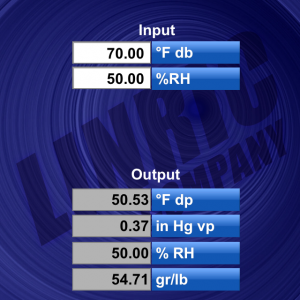

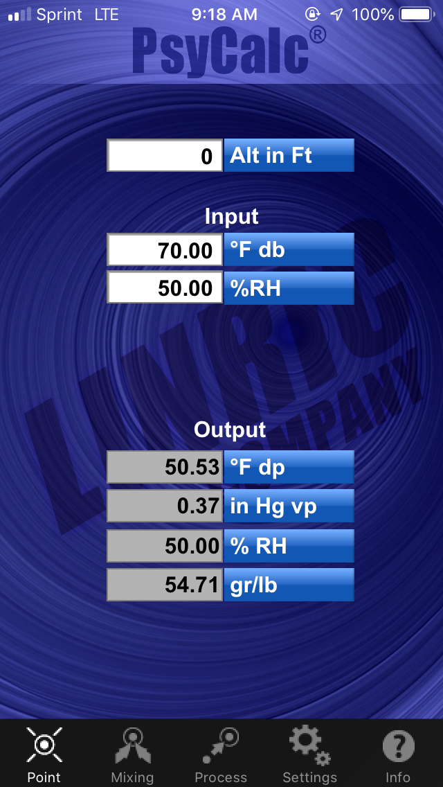

  4. Peter Yost | | #5
    I find it really handy to have this app on my iPhone: PsyCalc. Screenshot attached. Same app is available for android phones.
    Peter
