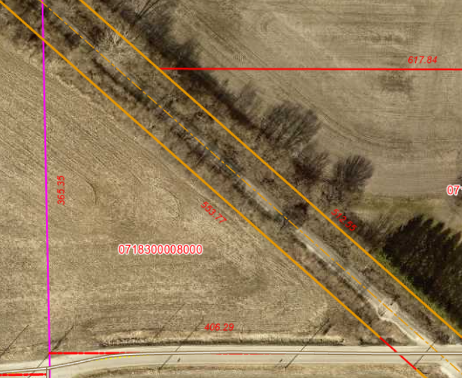

– Live in climate zone 5A, Muncie IN, just north of Indianapolis
– Here’s the link to our ashrae data for this location (city close by):
– Lot is a strange 1.7acre right triangle with an unobstructed southern exposure; Open to West side; Angular side is to the NE w/ trees all the way along
– Will be on a well
– Will be forced main / pressured to county sewer line
– Electric available; Gas is not
