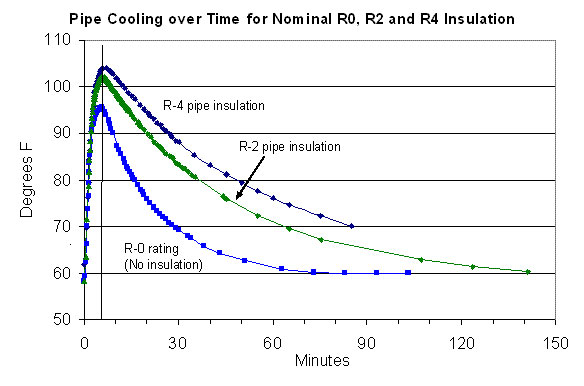

I am definitely getting into the weeds here for sure... Is there any way to determine what kind of standby loss is in the 3/4" insulated pipe filled with 1.5 gallons? because that is really the only downside right? I imagine if an hour later the sink is run again... could that water still might be 90 degrees or so? which will take much less energy to heat in the marathon?

This image was originally on a website, and is the result of in-situ measurements of temperatures in a potable hot water system at different pipe insulation R values:
http://www.terrylove.com/images/pipe_cooling.jpg
Clearly with R2 you have maybe 15-20 minutes before the hot water is too tepid to be useful for many applications, and at R4 that might stretch to 30 minutes before it drops below 90F.
Current code min is R3.
No matter what, after a full HOUR in a ~60F basement the residual temp of the water isn't a very useful for most hot water purposes, and nowhere near 90F.
