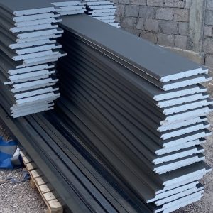

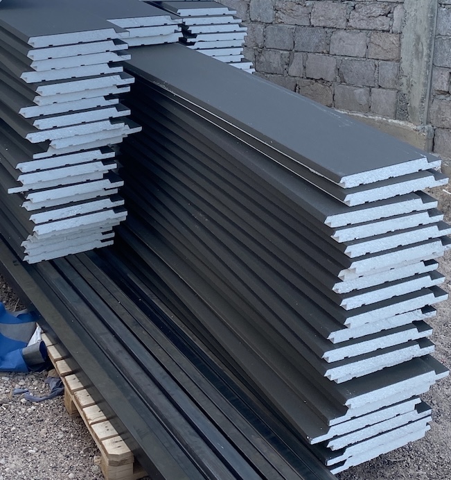

Hello,
Is there any benefits from layering different type of insulation (something cheaper than Rockwool ex. EPS/XPS) over the Rigid rock wool on the exterior? or it will cause more harm than good ? will it block the permeability of the Rockwool?

      What I'm trying to achieve is to not trap the moisture inside the house, the Siding that I will install is Epoxy + Quartz backed with EPS foam (2.2inch), I'm afraid if I install XPS / EPS under it won't dry to outside anymore. so will the rigid rockwool help if used under the EPS Siding? or its just waste of money and won't make difference

    1. SebMaz | | #4
