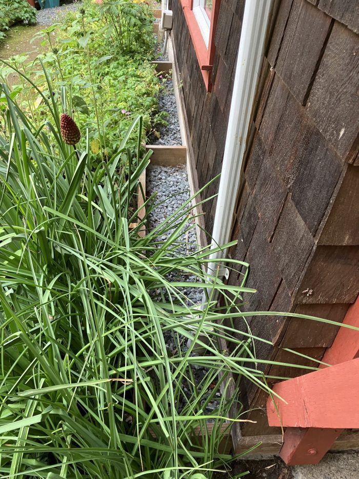

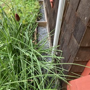

    1. Malcolm_Taylor | | #5
      MudJack,
      I have an above ground version on one wall of my house, which is there to act as a break between the raised garden beds and the foundation. During most rains the overhang means the crushed rock at the bottom remains dry. Any small amount of water that does end up there drains straight down through the rock.
      BILL WICHERS | | #6
      I second Malcolm's suggestion. If you get a lot of water, you could put some perforated drain pipe under the gravel to carry away water. This gives you a sort of aesthetically pleasing slot drain around the perimeter of the house, which will prevent you from ever having standing water near the exterior of your home. Ideally you could just drain to daylight somewhere downhill, but you could also put in a dry wall in a convenient spot and drain to that.
