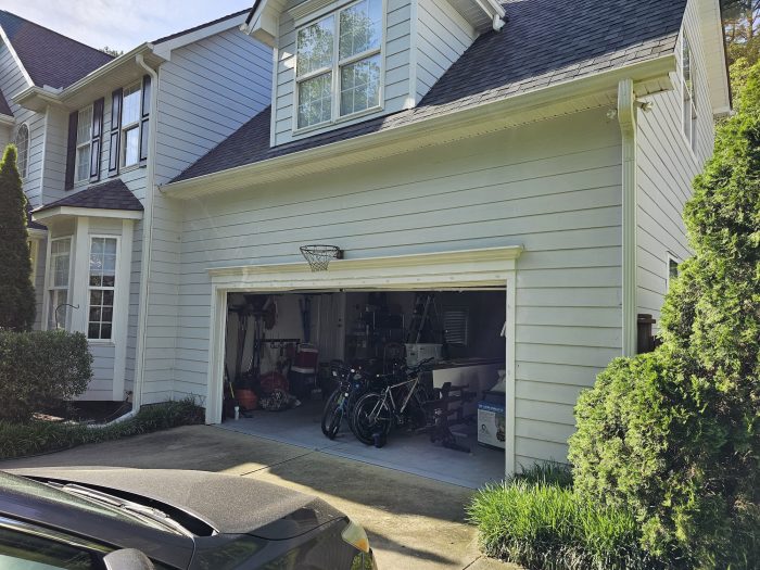

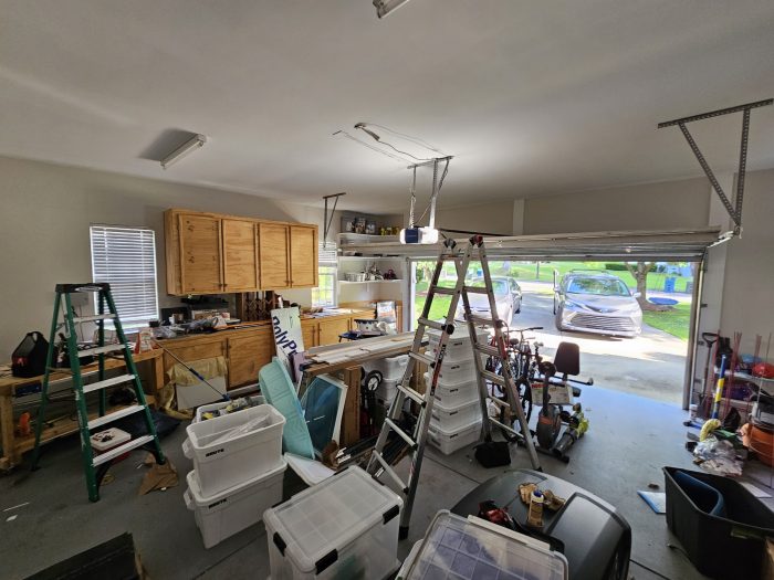

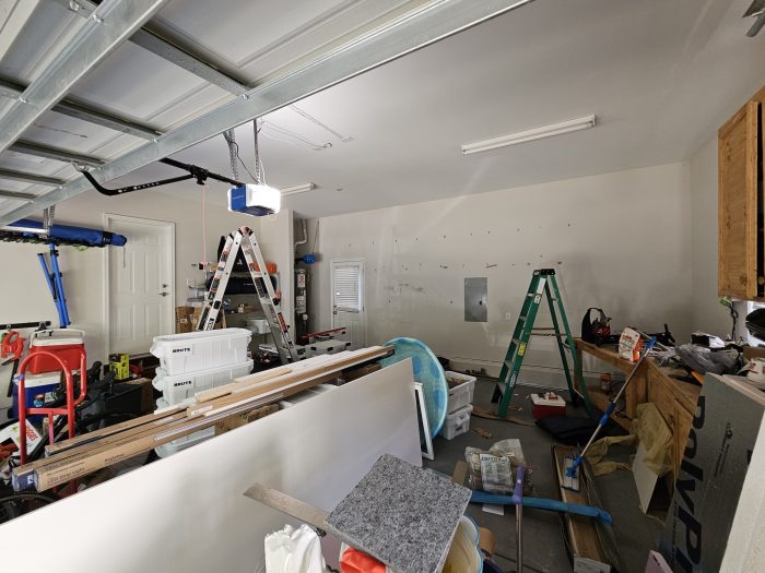

After a 2-year construction project elsewhere on the property, I’m excited to get my garage (which had become a staging area for tools/materials) organized and usable again. But before I start hanging shelves/organization on the drywall, I started to wonder if I should insulate the 3 exterior walls first, to try to make the space more comfortable in the summer and winter (central NC).
The house is ~20 years old, wood studs with fiberglass insulation, and fiber cement siding. The attached garage has 1 insulated wall and an insulated ceiling (bonus room above), but the other 3 walls don’t happen to have any insulation. The garage is a 23′ square with 10′ tall walls (8″ tall cinder block + 9’4″ of studs/drywall).
The current plan I’m pricing out is to demo the existing cabinets (which I don’t love) + drywall on the 3 walls, add faced R15 batts (to match the rest of the house) + some more outlets while it’s convenient, then replace the drywall. I have a couple ballpark quotes with varying amounts of labor from my side. For context, I’m mostly just trying to insulate the walls before continuing my organization project… however, eventually I’d insulate/replace the garage door and perhaps add a mini split as well.
