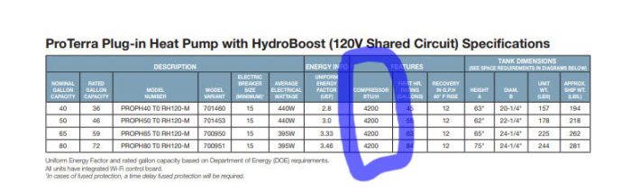

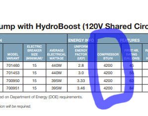

I have a Rheem Gen 4 HPWH. It's in my garage in Central Texas. It is my understanding that the unit is really only about 600 BTU, so the real amount of cooling is not really significant. Before I put a mini-split in my Garage so I could wood work year round, it may have had a slight impact on my garage's temperature and humidity, but wasn't going to make a huge difference.
