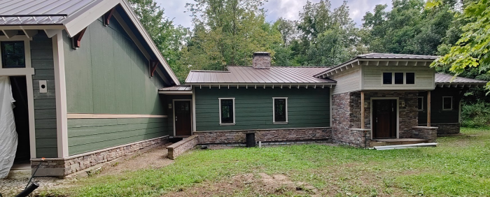

As I work to install an underground gutter or underground roof around my ICF house during construction, I am looking for a solution for how to finish the ground cover, particularly between the foundation and the drip line.
I have considered gravel, but inevitably, even with weed barrier fabric, weeds will grow. Perhaps this is still the best solution.
I could pour a concrete slab in this area, along the perimeter of the foundation, but that wouldn’t necessarily look very appealing.
I would really like to consider some sort of green cover, one that does not require a large amount of water, but this is likely a pipe dream without enough soil below to promote root growth – which is also probably problematic next to the foundation. However, I do like the idea of using natural plants to help control water.
I have attached a photo of the house. As mentioned, exterior walls are ICF. The central house is over a full basement with the remainder on conditioned crawl space. I have not had any problems with flooding or uncontrolled moisture in the past 2 years of construction. I do want to be careful about fouling the drainage tile at the footer on the outside of the foundation. The back fill around that foundation is about 2-3′ wide of pea gravel.
I cannot find any literature on GBA on this topic specifically. I look forward to any and all suggestions. Thanks

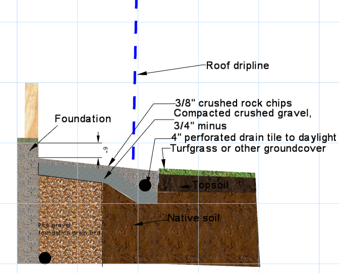

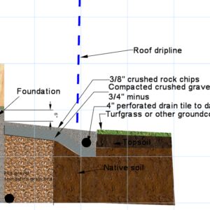

I would put a good edging (I like Curv-Rite aluminum) in past your roof's drip line. Pack in 3-4" of 3/4" with fines crushed rock sloping away from the house. If your pea gravel foundation drain bed extends upward in elevation to the bottom of the 3/4" minus rock, separate the two with a layer of fabric so that the fines in the 3/4" minus don't migrate down into your pea gravel. Put a small ditch near the edging for your drain tile running to daylight if possible. Then cover that with 1" of 3/8" clean limestone chips, Skreed off the chips, lightly tamp, then saturate that with a rock/mulch binder. You may have other colors/types of 3/8 chips available in your area that would work as well. That will largely hold it in place with light traffic/ rainfall off roof. Then add plantings/groundcovers as desired outside that. Keeps a nice dry area around the house, keeps plants far away for easy inspection of house/cladding etc, looks nice and is relatively inexpensive. Also is easier to blow out debris than, typical in my area, 2-3" river rock.
Could also install pavers for a nicer look at a greater expense if you are sure your foundation backfill is firm/stable.
Thanks for the suggestion. Would you happen to have a photo or 2 to share? Are you saying the limestone chips cover the drain tile all the way back to the foundation (over the 3/4" crushed stone)?
I don't appear to have any good photos but you can see the chips and edging in a path application here. And a drawing
That's helpful, thanks!
