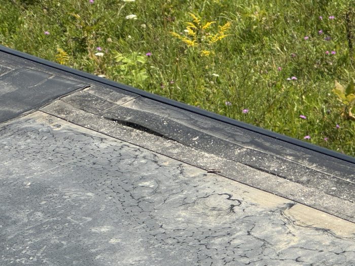

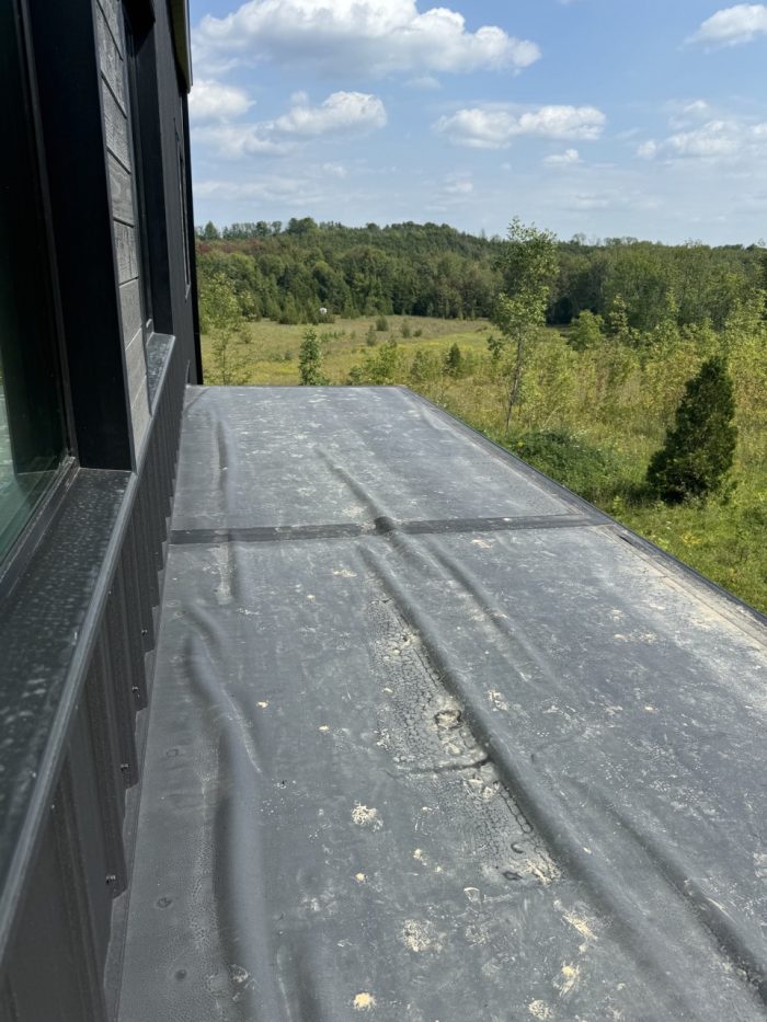

Is the membrane really supposed to look like this? See below. I intend to have the builder cover this roof with rocks, it is in view from the large windows in upstairs bedrooms, it also faces south so there is a disgusting hot rubber smell with the casement windows open. It would have been great as a green roof, but the architect decided this was best.
I think I’ve heard it’s actually more the siding connected to this roof that is at higher risk of water damage but I don’t see how this thing is not going to leak… I’m just thinking of the super expensive custom kitchen below this roof and I don’t have confidence this is going to hold up very well. Just curious if this looks normal because I have not seen many/any roofs like this from above. The wrinkling is worse now than it was initially ~ 5 months ago (photo below from late winter).
Is there anything to be done to improve this? I am not sure if I should have my builder do anything to fix this or if it is fine and we can just cover it with the rock garden/pea gravel.

    How old is the roof?
    While I would not worry about the wrinkles in the field, it is not top quality workmanship
    I would not expect it to be the source of leaks
    The edge needs to be repaired.
    I am not sure what is going on there, I would expect to see one piece of edge tape right at the edge of the roof over the drip edge

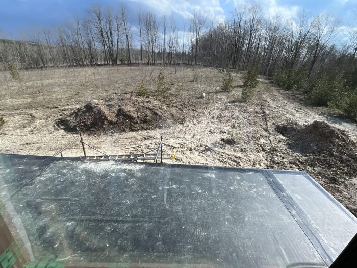

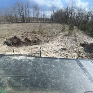

      The roof was done ~ 5 months ago. I notice that the wrinkles are more pronounced now than they were initially, see photo attached of how it initially looked. The seam on the left is that same seam shown in my current photo, so you can see the difference in the wrinkling. I will note that it was very wet (late winter) so it had been covered with a tarp prior to installation, but I would not be surprised if it was not perfectly dry under the membrane at the time of installation.
      We’re paying like a quarter of a million $ for a GC, it it unreasonable to expect them to redo this or repair in some way? I don’t understand how the project manager saw this work and approved/accepted it.

        I agree with gusfhb. It doesn't look good, and Im not sure what is going on. The lapping seems odd at the perimeter and whatever those small strips are they should be fully adhered.
    Michael Maines | | #6
    Good workmanship would not have wrinkles. It can be hard or impossible to avoid bubbles directly after installation, because of the adhesive off-gassing, but they should eventually settle down, not get worse. At least that's the case with fully adhered EPDM. I wonder if your installer only sealed the edges? I have heard that can be done if the field is covered with ballast (such as stone) but I've never done it that way myself or specified it on projects I have designed. In any case, it probably won't affect function.
    The fishmouth at the perimeter is a much larger concern to my eye. There are a few different ways of handling the perimeter, and there is a chance that this in only a piece installed for insurance. But in most cases it's an important part of the waterproofing system and should be fully adhered.
    Either way, this is not up to a minimum standard of workmanship, so yes, your contractor needs to deal with it.

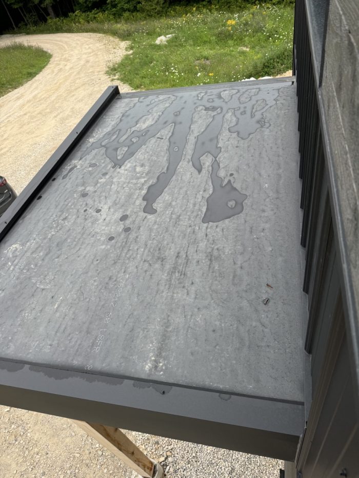

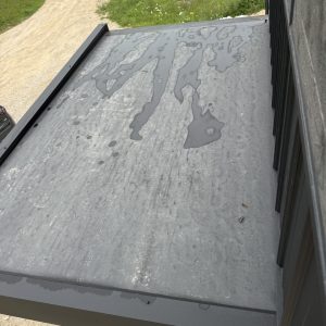

    The front entry porch also has a ‘flat’ roof but it looks a bit different, I am not sure if it is better but at least it is not over the kitchen! Additionally, this one is not sloped away from the house but rather to the side gutter. And when it rains we have dripping against the siding in that area, you can see a bit of pooling nearby on the upper right corner.

        The second one is on my current house, and it has some wrinkles similar to those pictured here, because it is a low pitch, it was a large sheet[~56x20] and was sliding down the roof. I don't worry about leaks from those, and after we split the sheet the rest of the roof was fine

      I noticed evidence of previous ponding in your previous pics
      On a truly flat roof EPDM does not mind a bit of ponding, as long as it is not over a seam or significant enough to stress the roof.
      EPDM is used as pond liner, so it doesn't care about water
