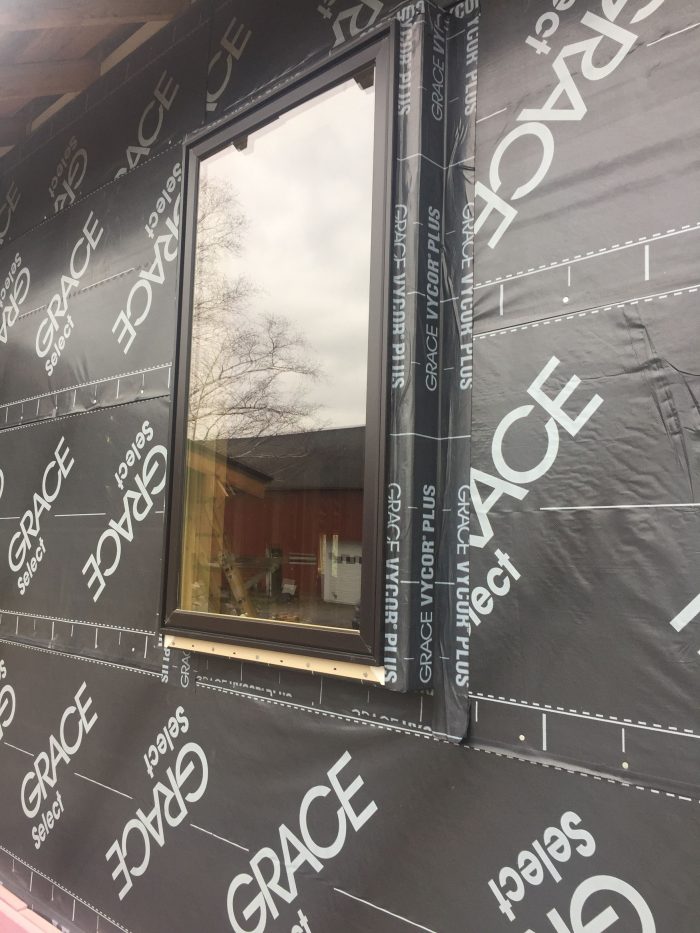

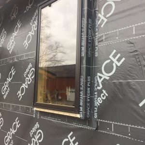

  2. seabornman | | #2
    Or you can build your frame out to make an "outie" install. Attached pic shows that type. Underneath the Vycor is a full 2x4.
      Brian Pontolilo | | #4
      That's nice work Joel! Thanks for sharing.
