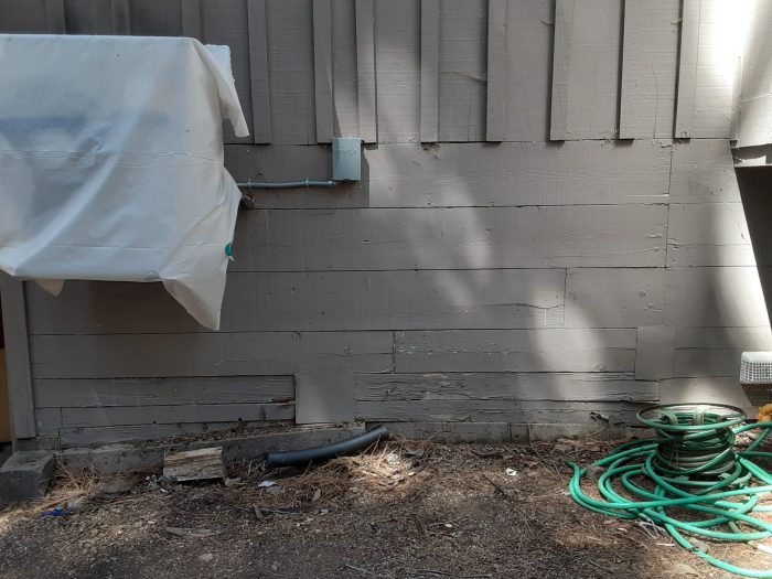

Hi everyone, my first post here: I have questions about installing continuous external insulation when replacing a 5×13 section of wall (the above-ground portion of an exterior basement wall, unheated, unfinished, laundry/mechanical room only).  Zone 5
We just purchased this house, and had to have Professional IICRC S520 Mold Remediation done, through which all the basement drywall, insulation, and tar paper was removed (1960 house), and the siding under the tar paper had the mold scraped off it by the remediation company. But we’re going to be replacing that section of siding because it’s in bad shape from the exterior (weather, insects, etc.), and also because replacing WRB would need to be done from the outside anyway.
We finally passed the mold clearance, the mold is gone, but we want to prevent it from coming back.  The mold inspector/environmental hygienist who did the clearance said that when replacing the siding/WRB on the basement laundry room, we should not have any insulation (even rigid foam) between the studs, or inside of the sheathing, and that if we have any insulation at all it needs to be outside the sheathing i.e. keep the basement unfinished, and the order from the studs out would be: sheathing, tyvek, rigid foam (we’re considering foamular XPS but open to suggestions), rainscreen, siding.  However, the contractor said in decades of installing siding here in the Northern CA mountains, he’s never seen insulation outside of sheathing, always between the studs (which the mold inspector said to avoid).  The contractor spoke briefly to the mold inspector and is open to doing it that way (i.e. continuous insulation on the outside) but would like to see more literature on that. The contractor recommended fiber-cement siding but is open to others.  This is just a 5 feet by 13 foot section.  Has anyone here ever installed foam-insulation on the outside of a building envelope (outside the studs/sheathing, just inside of the rainscreen/siding), and does anyone have a link to a resource that I can share with the contractor?

The wall we’re replacing that leaked is horizon shiplap, and the wall above it that the contractor would need to attach and flash to, is board and batton wood siding and tar paper (currently the vertical section above and the shiplap basement siding below, an unflashed gap between them which is probably one of the sources of the water damage). We don’t have the budget to replace all the siding, just the siding in the section that had mold that was remediated (i.e. the basement siding).  Also, the siding above that section looks fine according to the contractor and mold remediators.

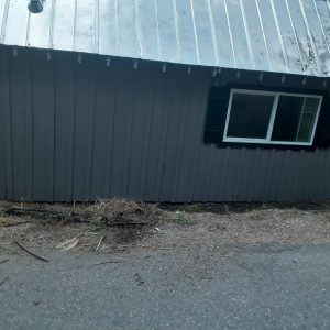

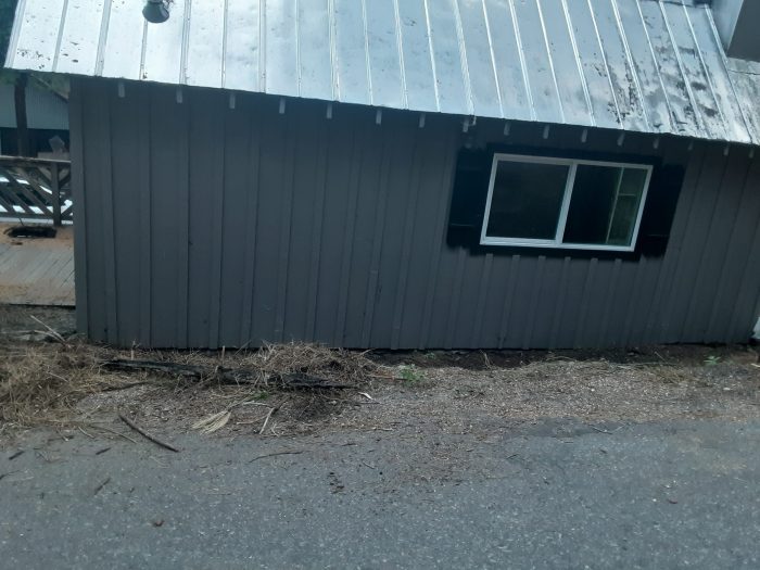

  1. CleanAirMountainCommunity | | #1
    I included a picture of the outside of that wall. Here are pictures of the inside of the wall (post-remediation -- they finished remediating but haven't removed the containment yet). https://photos.app.goo.gl/SAJ1mmm1mDKRrwew5 (please let me know if the photos don't come through). Thanks!
