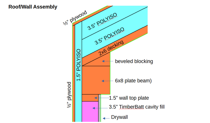

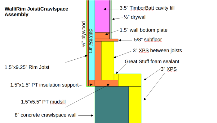

I’m building a small house (965 sq.ft.) in Downeast Maine (zone 6A). It will be post and beam construction with a thin layer of continuous exterior foam insulation (1.5″ polyiso) and 2×4 wall framing with wood fiber batt insulation in the wall cavity (3.5″ Timber Batt from TimberHP in Maine). The wall construction can be seen in the attached pictures (some simplifications in the images at the eave, but these are generally correct).
The wall construction is the standard offering from the provider of the house shell package that I am intending to use. I have some concerns that there is a potential for moisture buildup on the inner surface of the polyiso insulation at low outdoor temperatures.  Using the assumption that the polyiso insulation has an average R/inch of 5 (NRCA suggestion for polyiso), and that Timber Batts have an R/inch value of 4, I can calculate the temperature of the polyiso for a range of exterior temperatures.

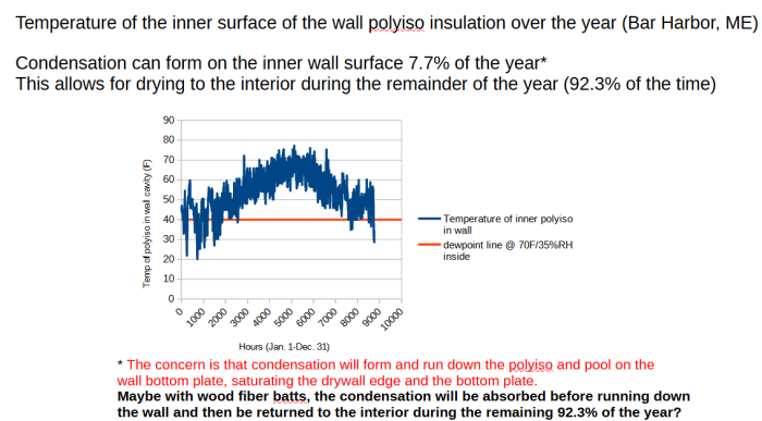

 I have obtained the weather data for Bar Harbor, ME which should have a pretty similar climate. From this I have calculated the polyiso inner surface temperature for a year (see Figure 3). It looks like the polyiso surface may be below the interior dew point about 7.7% of the year (assuming 68F and 35%RH inside conditions).
Question? Does this raise any major concerns? My concern is that condensation on the polyiso will run down to the wall bottom plate and puddle there, saturating the bottom edge of the drywall and the bottom plate. I’m thinking that the Timber Batts may absorb any surface condensation on the polyiso and return it to the interior when the polyiso temperature rises above the dewpoint, which would be 92.3% of the year. Comments?

            Akos | | #5
            The magic number to use is the average outdoor temperature over your 3 coldest months. This number comes from many test huts, it simply good enough.
            https://buildingscience.com/documents/building-science-insights-newsletters/bsi-026-they-all-laughed
            The wall still has a warm side vapor retarder, that painted drywall is a class III retarder, which will limit the amount of moisture that gets into the wall. You will still get some adsorption when the temperature drops bellow dewpoint, but these events are not long enough to cause any moisture issues. The assembly quickly dries once the temperature warms a bit.
  2. cliffhaven_rob | | #6
    Thank you Akos!
    That makes total sense. For my climate data, the three coldest months average out to 27 F. At that temperature my wall construction yields a condensing surface temperature of 44 F. Good to go!
