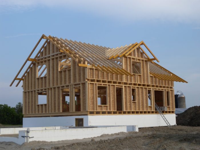

  8. albertrooks | | #8
    Daniel,
    A friend (Anderas) just sent this pic down from Toronto CA. The builder is Andreas Herman, Hermans Timber Frames. Im posting this one to just show where the interior OSB is used to pick up racking. The stud bays get blown and the exterior sheathing will be Pavatex which is a Swiss high perm wood fibre board just like the Agepan that we use.
    If you expand the picture, you can see Green Siga tape on the interior side of the OSB to create the air barrier. From there he puts a service cavity. The typical Swiss method is horizontal 2x3's rather than verticle.
    Pretty simple method and no problem with rafters on a warm or cold roof system.
  9. LucyF | | #9
    That building is so beautiful as it is being framed.

    Regarding the Toronto house you posted a photo of earlier in this thread having an OSB air barrier on the inside of the framing, would you explain how the air barrier is maintained through the 2nd story floor joists, and how is it continued into the ceiling?

  31. albertrooks | | #31
    Reply to Jack Wolf:
    Jack, you asked:
    "Albert Rooks,
    Regarding the Toronto house you posted a photo of earlier in this thread having an OSB air barrier on the inside of the framing, would you explain how the air barrier is maintained through the 2nd story floor joists, and how is it continued into the ceiling?"
    With the details so different to what we are used to, and probably interesting to many of us, I thought I'd post an answer since I just got new pictures from the builder Andreas Herman.
    The Siga system that we stock at the Small Planet Workshop - http://www.smallplanetworkshop.com has a lot more to it than just a flat piece of tape. You can see in the picture that Andreas used the Green Rissan 60 tape to sealing the OSB panels at flat joints and then the pre-folded corvum 30/30 at the beam intersections. The Corvum 30/30 has 1-1/8" legs so that the infill OSB doesn't have to be cut too tight.
    Using sheet stock material as the internal air barrier, and vapor control layer and to pick up racking is a very common way to build a wall with an increasing diffusion gradient to the exterior. The exterior layer is targeted to be 10x more permeable than interior layer. Hence the continual quest for highly permeable exterior sheathing.
    Returning to your air sealing question, Since air sealing this way has to deal with varying materials and conditions, companies like SIGA have created a pretty wide range of products to take care of the applications in quick simple steps.
    Btw... I think that we have to agree that Andreas does really nice work :)
