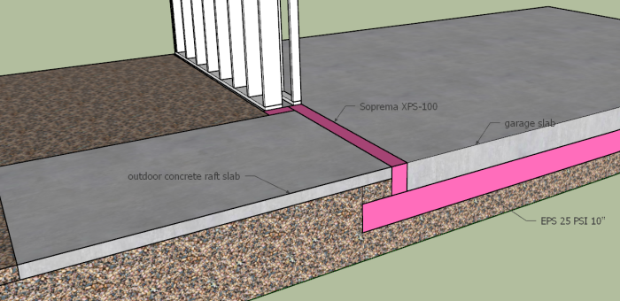

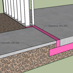

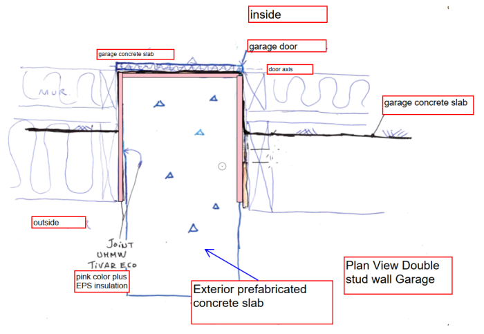

Digging this up again with another idea. Please see the attached drawing and provide feedback if you have any.
Thanks.
Hey Trevor - did you ever settle on a solution to implement at the door?

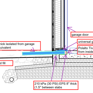

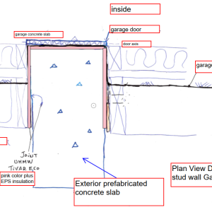

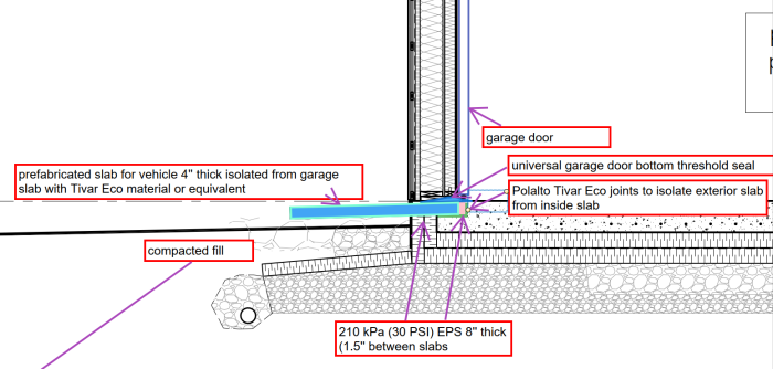

Not really. The engineer came up with something that I'm not entirely happy with. There's a thermal break between the apron and the slab, but because of where the garage door needs to be placed, there's part of the slab exposed to the outdoors. It actually looks to me like the thermal break is pretty pointless.
The man door solution is kind of similar, but I can imagine some pretty simple mods to make it better.
That looks like it will work. At least you have a couple of vertical layers of insulation between the slab and the apron. Mine situation at the garage door is a bit different, 'cause the conc. contractor add some 'cut outs' in the stem wall below where my garage doors are going--as in atch'd image, but longer. So, my vertical XPS would have no support in that area.

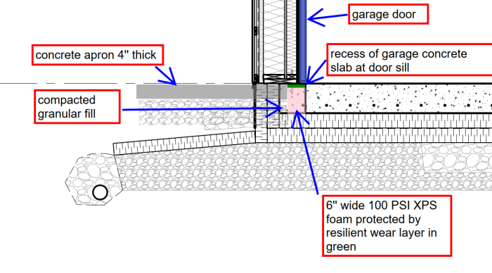

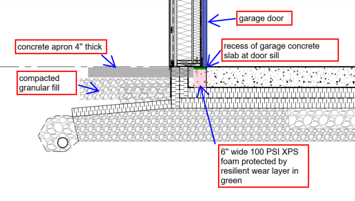

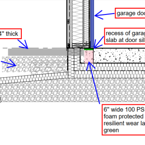

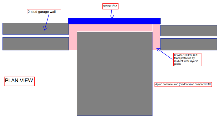

For anyone's consideration, what do you think of this modification? I've got a sample of the foam, and the combination of the foam with the fibreglass seems very resilient. I'm going to try driving over it a bunch of times.
Is it really 22 psi? If so, I don't think it will hold up well, but if it does, the thermal break aspect would definitely help.
That's what the rating is. I could use something higher, as I've seen 40psi EPS and 60psi XPS. But then I'd lose that fibreglass skin, so I'd have to put on another wear-resistant layer. The way I see it, that compressive rating determines how much it will compress, it's not like it's going to shatter into pieces if you apply a little more force.
I think it will just spring back after the tires drive over it. And if I'm wrong, I can try something else.

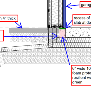

So my compression test didn't go well. I drove a pick-up truck onto the polyurethane foam, and it compressed more than I expected. Worse, it did not spring back like I've seen EPS do in the past.
What if I used this product instead?
https://www.soprema.ca/en/products-systems/sopra-xps-100
It's XPS, but they claim a GWP of 1. 100psi seems like a lot. They also have a 60psi version, which might also be adequate.
Trevor, foam load ratings are for 10% deformation. If you add more load, it will compress further, eventually exceeding its "plastic state" which means it won't bounce back.
A car tire might have 1,000 lbs on it, with 10 square inches touching the ground, or about 100 psi. The foam might be able to handle 4X its rated compression resistance but I wouldn't count on it.
Edit to add: I was responding to post 24, before reading post 29.
100 psi foam would probably work for you. Staying true to foam companies' typical lies and obfuscation, the product doesn't have a GWP of 1, its blowing agent does. That's much better than legacy XPS but it's blatent false advertising.
I was assuming a larger contact patch for the tire. 10 square inches with a 8" wide tire means only 1.25" cross section touching the ground. Just looking at a car tire, it seems like there's a lot more touching the ground. Isn't the pressure on the ground going to be pretty close to the air pressure in the tire, minus the force required to deform the tire?

Yeah I was thinking of a compact car with a 6" wide tire and 2" contact patch, then rounded down to 10 sq.in.. Then I read that you used a truck, which probably has an 8-10" tire and 2-3" contact patch for 16-24 sq.in., let's say 20 sq.in., for about 50 psi of pressure rather than the 100 psi I had first estimated.
The air pressure in the tire doesn't have anything to do with the pressure on the ground. I'm sure there's some sort of relationship but I can't recall how to do the math.
I saw this thread yesterday and came across these images in a door catalog today. Pretty much like Malcolm described I think.
Your idea from 2/8 is exactly what I have done in the past. Having the insulation outside the door plane is, umm, silly.
I would rather have two inches of freezing cold concrete inside my garage than have my entire slab wicking heat out of the building
Car tires will never touch the foam, whatever you want to put over it for cosmetic reasons is fine.
There is no problem having the foam where you placed it. Simply set the form there, then pour the apron afterwards.
If the architect doesn't agree, smile nod and ignore him.
Set the form for the floor at an inch+ inside of the wall
I'm trying to think of a situation with exterior insulation where the door would be in line with the foam but I'm coming up blank. Perhaps you had foam on the interior of a stem wall? That could work, if you don't have thick walls, but I can't see how it could work with a thickened-edge slab.
The problem with that idea is that the door won't actually align with where I have it in that drawing. This is what the engineer said when I showed him the drawing:
"The door has to be inside the building for the track hardware."
While mine was indeed interior insulation, is it not just a matter of moving the thickened slab edge inward at the door aperture, or does that raise other complications?
Sorry but if I was putting 6 inches of foam under a slab you would not find me exposing the edge to the outside world
Most of the thoughts I have involve enlarging the door aperture
Looks like there is an inner and outer wall....think with some thought if you cannot move the floor you can move the door mounting within that wall.
There is a mounting plane for garage door hardware, what, 2 inches on either side of the door. It is simple to define that as the inside of the wall, but there is little reason you cannot make that differently if it serves your purpose.
It would be possible but you would have to jog the thickened edge in at the doors, since the wall framing at either side of the door has to bear on foundation and overhead doors are always inboard of the wall framing.
