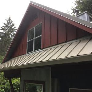

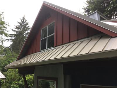

        I only use fascias on gable ends where they are a visible part of the facade. We are lucky here in that we have access to dry, good looking MPS pt lumber which takes stain or paint well. So that's what I use there, but I'd be comfortable cement-based materials too. I agree with your architect: If they are visible, I don't like the look of coil-stock.
        At the eaves when there will be gutters, I use 5" fascia-gutters attached directly onto the 2"x4" sub-fascia as I don't think a finished fascia of any material adds much there except maintenance. If I was going to use one I'd probably have it covered by coil stock.
        The attached photo shows both conditions on my house. Pt fascias above and 5" fascia gutters below
        1. MikeonLI | | #6
          Malcolm, thanks for the helpful responses and the photos. I really appreciate it.
