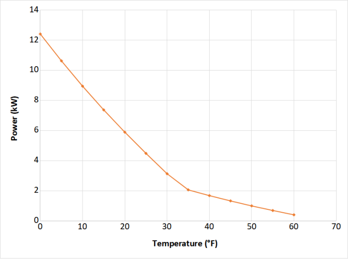

I don't like undersizing the heat pump and relying on strip heat. My house has twice the heat loss of yours in a milder climate (17 °F 99% design point), but look how ugly the power use vs temperature graph is for my undersized heat pump (attached). With mass adoption of heat pumps, which should be the goal, we'll all be hitting those extreme peak power draws at the same time. I'd save the strip heat for emergencies.
Edit: But bigger capacity doesn't automatically help. For example, the suz-ka24nahz gives 23 kbtu/hr at 5 °F, while the suz-ka18nahz gives 21.6 kbtu/hr. The larger unit uses 454 W more, which is more than the difference in capacity. The smaller unit is actually pulling in more outdoor heat.
