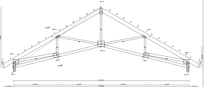

Location: Nova Scotia, Canada (Zone 6 lite). Building dimensions: 22′ x 32′. Roof: 7:12 Gable
Has anyone partially / fully built a trussed roof on the ground and hoisted it onto the walls? Any learnings that you’d like to share? I’m considering this for a current build as I have plenty of flat space and an aversion to being up 25′ in the winter. The truss manufacturer will not comment on the best pick points for such a lift, unfortunately.
Specifically, I’m curious where and how to best hoist this roof. The interior vaulted ceiling is a 3:12 pitch. In an ideal world, I can sheath and (mostly) install the metal roofing, leaving only the ridge exposed for strapping to be lowered to the bottom cord.

    I've done what you're describing... I would just throw a couple 2x10 on either side of your middle king post on your truss tight to the top and lots of 2x4 bracing. The tricky part is going to be making sure you measure and square everything pretty close to perfect. I would build my floor and then build the roof on the floor, then crane it off, build the rest of the house before craning it back on. I've done this and know others who have as well and it worked great. It ensures your roof will fit. Talk to your crane operator beforehand, they usually have experience with it, plus you want to make sure you're OK on weight. Good luck!

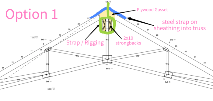

  9. Ry_Buc | | #14
    Latest lift / rigging design. I welcome any feedback.
      MALCOLM TAYLOR | | #16
      Ry_Buc,
      The trusses are engineered to bear on their raised heels. I think the the closer you can get to mimicking that the better.
      1. Ry_Buc | | #20
        Thanks, Malcolm. I'll have a think about how we might accomplish that. Leave outs likely, which negates some of the value of doing it on the ground. But maybe a more structurally-sound approach.
          MALCOLM TAYLOR | | #22
          Ry,Buc,
          With a snap-lock metal roof you can still leave several panels screwed down but not snapped to their neighbor, which would provide access for lift points.
      DCcontrarian | | #19
      I wouldn't take advice from anyone here, I'd see if the truss company engineers can help.
      It's possible to stress an assembly in such a way that it shows no visible damage but it's been weakened.
      1. Ry_Buc | | #21
        Fair point. I'm taking advice from a wide swath of folks to vet the idea. Unfortunately, the truss manufacturer won't say a word on the matter. Liability.
  10. steve41 | | #15
    Seems reasonable, but the only reliable way to determine the suitability/safety of the rigging plan is with engineering analysis.
    Otherwise my $.02: for extra safety, maybe find a way to attach some high tensile steel strapping from one eave to the other over the peak to better counter the vertical forces at the ridge. (basically extend the blue strapping you have sketched)
    What's the estimated weight of the roof assembly?
    1. Ry_Buc | | #18
      Conservatively 5500 lbs.
