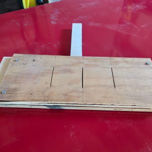

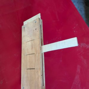

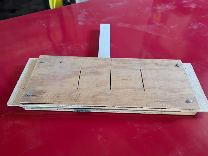

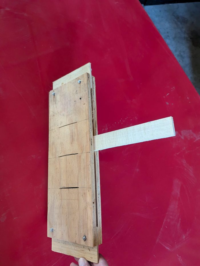

The best price/inch I've have found as a homeowner is to buy the larger 6,9,12" wide rolls off ebay. Then make a 'jig' like below where you place the shim for the width (if not 12") and then hold boxcutters in the slots while another person pulls the tape through. Works great.
