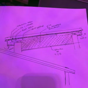

          I've attached a picture of what I believe this assembly would look like, borrowing from the "5 Cathedral Ceilings That Work" blog.
          I've only got a bit of attic, and it has all of our HVAC and electric water heater in it. Where my ignorance is most expressed is in not understanding how an air permeable insulation layer would be sufficient to prevent both my heat leaving the house in winter and the humidity of CZ3A from causing problems with all that moisture floating around freely.
          Assuming this works, I'd just look to get some Smartbaffles and define what, 6" of ventilation space? Do I need my insulation fully up against the baffles, taking up the entire cavity between baffles and ceiling?
          Forgive the UV plant lighting making my sketch look insane, haha. Also ignore the other roof drawing below it!
          1. Malcolm_Taylor | | #7
            swooley,
            Going to 2/12 definitely calls for a deeper vent space and more diligent air sealing. Going below that becomes very problematic because each reduction in pitch - say for 2/12 to 1.5/12 - represents proportionally a big drop.
            Your situation gives you a large advantage. The depth of the trusses means you have room for as much cellulose or batts as you would like and still allows plenty of space for a deep vent channel. The simple roof shape also allows you to vent the soffits on all four sides.
            I would not install baffles. You can make up for the slight diminution in R-value due to wind-washing by adding a bit more insulation, and it will be well below the air inlets If you leave a deep cavity. With R45 you are looking at that cavity still being at least 10". That's the direction I would explore.

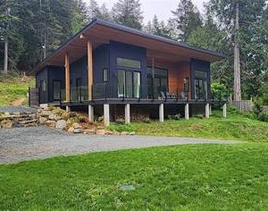

            This house, just down our road, has almost exactly the roof assembly I'm suggesting. The same pitch, metal roof, 2 ft trusses and permeable insulation.
        3. swooley | | #8
          Malcolm,
          So wait -- I can just have the following stack?
          Standing Seam
          Ice and Water
          OSB Roof Deck
          --AIR SPACE--
          Batts/Cellulose
          Drywall
          If that's the case my options for insulation absolutely skyrocket. I was looking at $2,000 in SmartBaffles which really made the cost and labor difference non-ideal.
          That would be incredible news. And then I just make sure to keep the side soffits and main soffits unblocked by insulation and I'm good?
          1. Malcolm_Taylor | | #9
            swooley,
            That's exactly how the house I posted is built, although I don't think they bothered to vent the soffits on the sides.

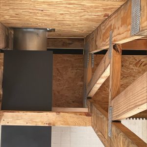

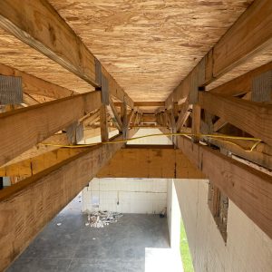

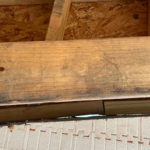

          Images attached of looking down and up my trusses. I'm up about 18ft on scaffolding. The black box is the wood stove pipe and the soffit is just beyond it. I've also attached a picture of the sidewall, where the ICF meets up with the roof. I'll clearly need to airseal this (going to do EPS on the exterior and probably just run a line of foam on the interior).
          There's not exactly a super clear channel for air/ventilation given the 2x4s run perpendicular to the trusses around where the soffits are.
          My plan would be to get a set of R30 Knauf Ecobatts, as well as a set of R19 Ecobatts. Start with an R30 batt, push it up in the ceiling a little bit, then slide the R19 under it until it's flush with the bottom of the truss. That's 16.25" of batt, which leaves about 8" of empty space between the roof deck and the insulation.
          Then I'll install drywall and focus heavily on air sealing the drywall. I only have 4 roof penetrations (4 ceiling fans) so that shouldn't be too difficult.
          You'd say this is the best, or at least a recommended, assembly for all the variables involved? Can this really vent soffit to soffit when the holes are on the underside of the soffit on both the high side and low side?

          1. Malcolm_Taylor | | #11
            swooley,
            That would be what I'd do. Leave the first batts slightly low so when the second ones go in you know you have at least 8" clear vent space.
            I don't see any problem with the vents being on the soffits. If it worries you, it's easy to vent the metal at the peak, much as you would a gable roof.
