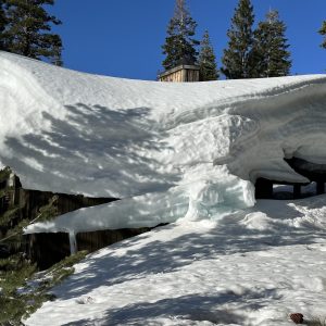

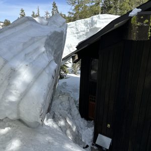

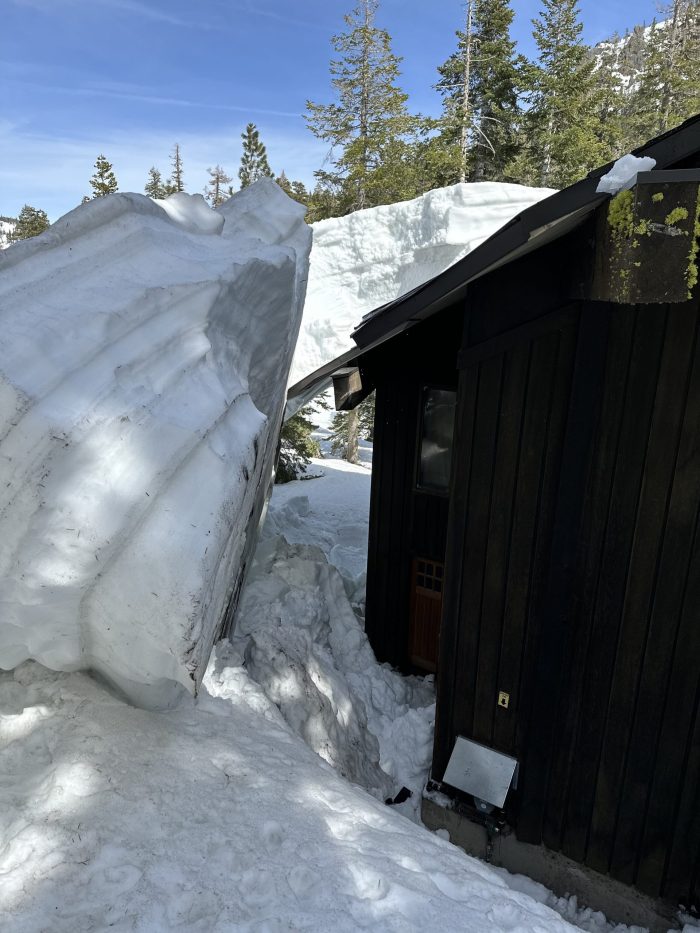

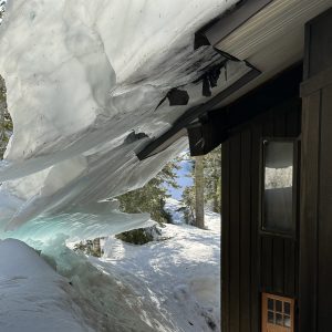

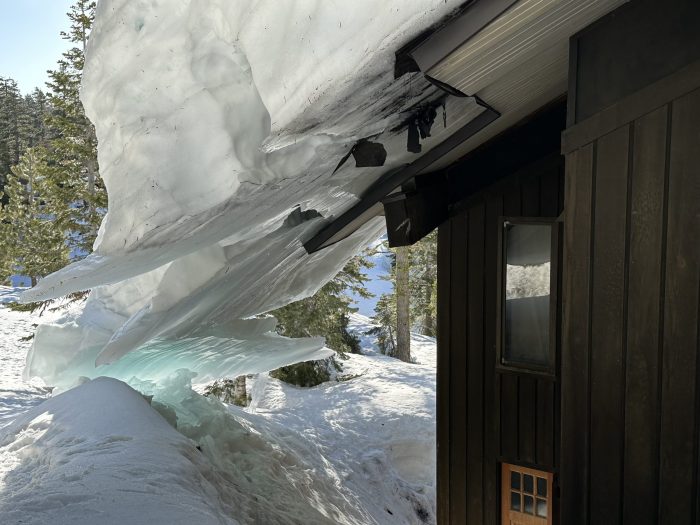

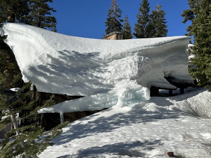

    3. zetetic | | #28
      No rafters. Literally 4" thick T&G between the interior and about 10 ft of snow. Just a layer of tar paper and composite shingles. No air barrier.
      If you ever wondered what sort of ice dams an R4 roof produces, see attached photos of our home from Spring 2023, a 701" snow season.
      Certainly debatable, but the ice dams are why we are choosing to go after the R4 roof ahead of the single pane windows.

        1. zetetic | | #32
          Thanks.
          You could hear the house creak and grown the day before, but no jammed windows or doors. On the day of the slide, I decided to dig out the steps while waiting for the ice dam to come down. It was sunny, I knew it would trigger.
          When it slid, it felt like a solid California earthquake when it impacted. I was standing 40 feet away, shoveling snow, of course. Lost a few shingles.
          We'd been planning to do the addition since 2018 - we have no garage or driveway. This particular slide, and having to dig out the propane tank from under 15 feet of snow that winter to fill it, helped make the decision for us to finally go forward with the addition.
          I think the neighbors will miss our ice dams more than we will.
          My favorite feature of the project is the new and bigger 1000 gallon propane tank under the new driveway *with a manhole cover in the driveway* over the filler. Driveways get plowed by the HOA. Amazing it was approved. One less thing to dig out.
          Need the propane tank (definitely not green) because power goes out for days at a time (wildfire, or an avalanche takes out a power pole and transformer), so we need a whole house generator. Nowhere to put solar when we need it most during the winter. No power and only a fireplace with 22-foot ceilings, an R4 roof, and single pane windows gets a little tough after a few days.
          Really grateful to have the members and experts of GBA guide us through our projects, large and small.

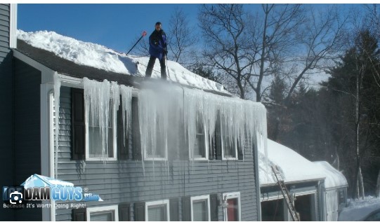

          1. begreener | | #33

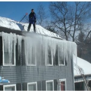

            Did you get water inside as the result of these "ice dams" ...
            Here in New England, that's the reason we use the word "dam" ...
            The snow melts, turns to water from the underside of the roof heat loss, then the melted snow runs off the edge of the roof where it immediately freezes & turns to ice.
            This ice then starts to build-up in such a way that it forms a "dam" that the melting snow/water then backs up behind & enters the house...
          2. zetetic | | #35
            @begreener
            No leaks. I think the 6.5:12 roof slope helps, as do the 3-foot eaves. We put standing seam on the eaves to help the sloughing process. If you look closely at the photos, you can see the grooves from the standing seam in the underside of the ice dam.
            I think the ice dam forms, but then instead of continuing to fill with water, it slides a bit from the weight of the ice and water, thanks to the standing seam and the steepness of the roof. If it leaks, it may leak through the eave.
            We intend to insulate not only the roof, but the full eave, so that heat loss from the walls below do not melt the snow on the eaves.
