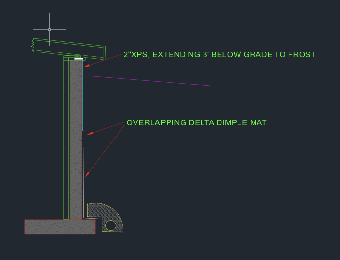

  2. MikefromtheMountainsofUtah | | #3
    How does this look? Complimented by a space behind the interior stud wall for closed cell and R-19.
      MALCOLM TAYLOR | | #4
      Mike,

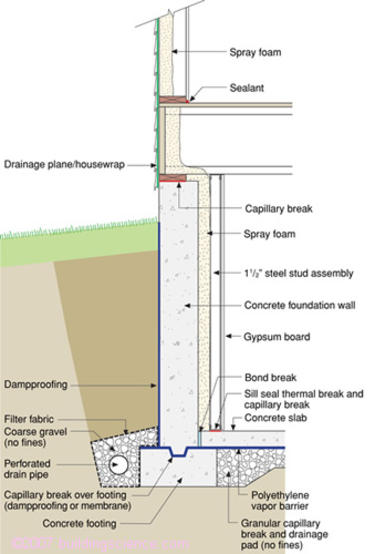

      The purpose of the exterior foam is to both reduce energy loss, and keep the inside face of the concrete warm enough that the warm interior air does not condense on it. If that foam is not continuous, it will do the first, but perhaps not the second. Like Onslow I would suggest moving that foam to the inside. https://www.greenbuildingadvisor.com/article/three-ways-to-insulate-a-basement-wall

          MALCOLM TAYLOR | | #8
          Mike,
          No I'm saying the opposite. If you only cover the top, the part below will have no exterior foam to keep it warm enough to stop moist interior air condensing on it.
          Every part of those walls needs foam on either the inside or outside.

            MALCOLM TAYLOR | | #10
            Mike,
            My preference is to have the foam board inside as it doesn't need protection, the foam can be made continuous with that under your slab, and it removes doubt as to whether the inside face of the concrete will become a condensing surface. However if the walls are going to remain unfinished I agree with Onslow that exterior foam may be a good choice.

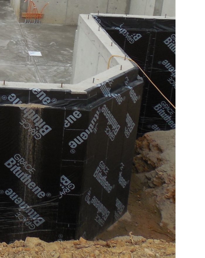

    I have attached two views of my own resolution to exterior insulation on my foundation. Not to cross swords with Malcolm, but I guess I did not make clear my support for insulating ONLY on the outside of foundations despite the nuisance detailing involved. Thermally speaking, it makes the most sense in CZ 5-7. Termites could be a deciding factor for some. My own home, above grade, is also clad in almost 6" of exterior foam (in total), so the problem of siding plane to foundation plane differences resolved in my favor with about a 3" offset that makes the "belt line" look normal. If you are not doing CEI on the framed portion of the house then you will likely have a reverse offset in the siding to foundation surface planes. Awkward looking and even harder to detail.
    You indicate that the grade falls from 8' to zero, so the frost line is moot for a couple of reasons. If I am envisioning correctly, at least 50% of your foundation surface area will be above grade. The portion that is more fully "earth moderated" will only net small reductions in net losses compared to the exposed parts. Even adding the 2" layer on the outside will be heavily defeated by ground conduction losses. It may help to think of the foundation thickness as being equivalent to a large air gap between interior insulation and exterior. I will admit to being too lazy to breakout my calculator and prove this.

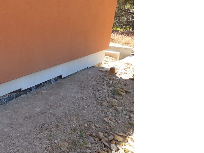

    First photo: Instead of adhesives we also used ramset anchors to secure the 3" reclaimed XPS to the foundation. The failure rate of the fasteners seemed excessive. But for the damp coat on your concrete I would have suggested Fuzeit or similar foam compatible adhesive. Not sure what to say will stick now. The Grace Bituthene skin was my choice to seal the foam and its gaps against ground water intrusion. Backfilling was a bit of a nightmare given how tender it was. I ended up using very thick polyfilm to protect it though dimple mat would have worked too IF it would stay in place without fasteners. No sense sealing everything only to shoot holes in it. As I noted, lots of PITA details.
    The second photo is a view of my chosen skirting solution to protect the exposed portions of the Bituthene. Much of my exposure was the required 6", but one corner is about 3 feet. You indicate going to daylight on the downhill side, which makes my choice of Hardiboard rather tricky. 3'x5' is the largest size I am aware of. There are aggregate covered foam panels that are bigger, but pretty much only sensible for commercial scale use. There was a sort of recent article about one version in Fine Homebuilding or GBA. The Hardiboard I used is suspended from an unseen element that supports my exterior insulation. I aligned the panel seams with aluminum stock and washer head screws.
