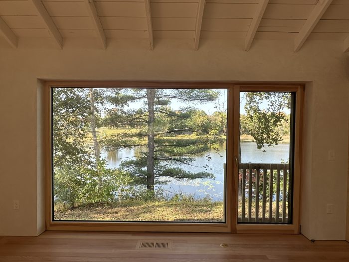

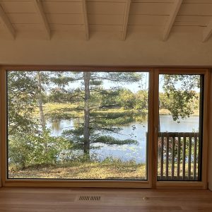

They arrived. They’re beautiful. I haven’t lived with them nor had the blower door yet, but they’re fantastic, and the sales and technical team are very helpful. They’re Ideal windows and j think Neuffer is the distributor. Get a bid, you’ve nothing to loose.
