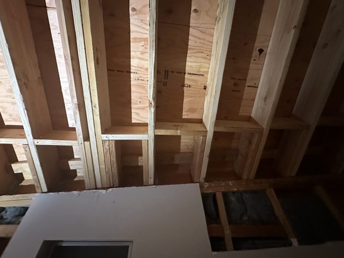

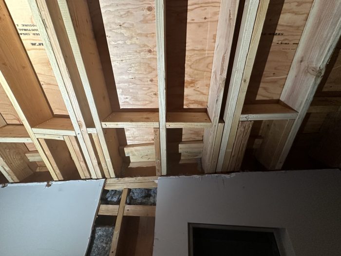

Hi all,
Trying to air seal rafter/soffit blocking but it involved a repair which required sistering rafters. The soffit area is a mess of sistered lumber and I’m trying to get a good air seal for an unvented roof assembly.
Is there any spray sealant that is available that can air seal the soffit blocking and parts of the rafters/roof sheathing without needing to use spray foam?
GBA Detail Library
Perhaps Pro Clima's AEROFIXX system to apply their VISCONN air sealing product would work?
