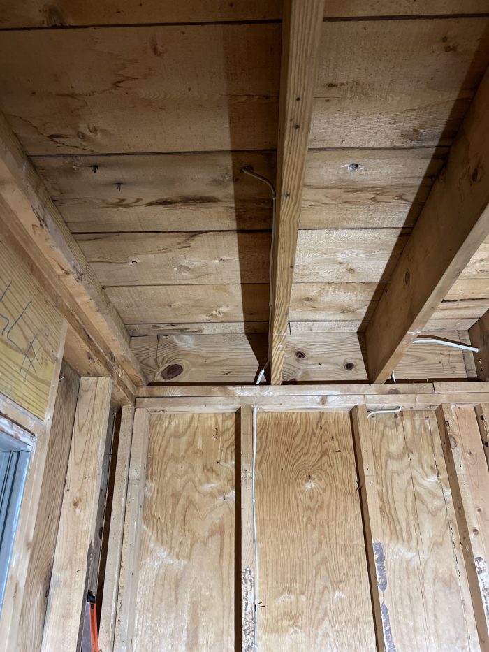

I recently bought out of foreclosure a 1982 modular house in upstate NY (climate zone 6 but on the edge of 5).  The 2×4 construction is in decent shape, but I want to upgrade the thermal envelope and convert the electric heating to a mini-split.  I’m replacing all of the interiors and I’ve demoed out all of the sheetrock and pulled out the pink insulation.
I’ve been reviewing the various options for the thermal envelope upgrade, and as I am planning to replace some or all of the existing windows it seems that perhaps the best way to upgrade the envelope is a layer of exterior insulation.  This requires me to replace about 1000SF siding which is an unfortunate cost, but it will let me add some curb appeal to a currently beige house.

    On another note - Since I have already demoed the interior, and since the winter is coming and the exterior might not get done till the spring maybe you can advise on the best approach to insulate the interior. I want to do this now so maybe I can get a little temp heat in the house to let us work more comfortably thru the winter. This I would do myself and I was thinking to use mineral wool batts. Do I need to do any air sealing before I add the batts? I'm not demoing out the ceiling or any of the attic insulation (I will add more, but not remove what is there). I was looking at maybe using intello membrane, but I don't know how I can use that since I'm keeping the existing sheetrock ceilings (they are low at 7'-6" AFF). I hope that question makes sense.

    You can choose from a wide variety of insulation materials to install between your studs. Installation quality matters more than the material you choose.
    Regardless of which type of insulation you choose, you need a well-defined plan to address air leaks. If you want to delay the installation of your air barrier until the exterior work is performed, that's possible. (Many builders used taped exterior sheathing as their primary air barrier.) You should know, of course, that your walls will continue to be leaky until you get around to installing your air barrier.
    If you want to address air leaks from the interior, one possible approach is to install open-cell spray foam between the studs. (In your case, open-cell spray foam is better than closed-cell spray foam, since open-cell spray foam works better with exterior rigid foam than closed-cell spray foam. Open-cell spray foam allows a wall to dry to the interior.)
