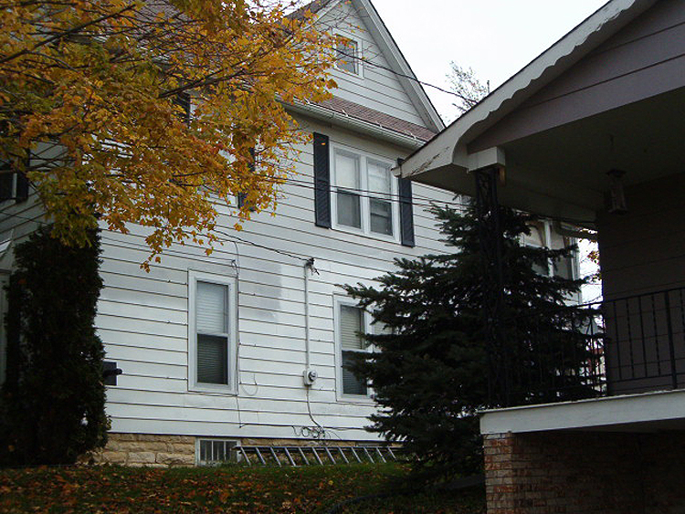

Each year, Northeast Iowa Community Action Corporation (NEICAC) uses state funding to weatherize about 100 homes. On this 100-year-old two-story home, and others like it, weatherization crews have performed a variety of diagnostic tests and implemented low-cost, high-return strategies for improving overall energy efficiency — without extensive modifications.
This 2,500-square-foot home is typical for the area but larger than many of the houses in NEICAC’s program. The work done on this house reduced air leakage by almost 50%.

For this home, one of the trickiest spots was an open porch with a roof above it. The wall and floor cavities of the adjacent conditioned spaces of the home have nothing but board sheathing between them and the enclosed porch ceiling. Because the crew realizes that this is a common situation in many homes of this era, these thermal flaws are spotted quickly. The required solution — opening up the porch ceiling so that workers could climb in — was a bit more invasive than most weatherization procedures, but that was the only way to get at these gaps to seal them.
