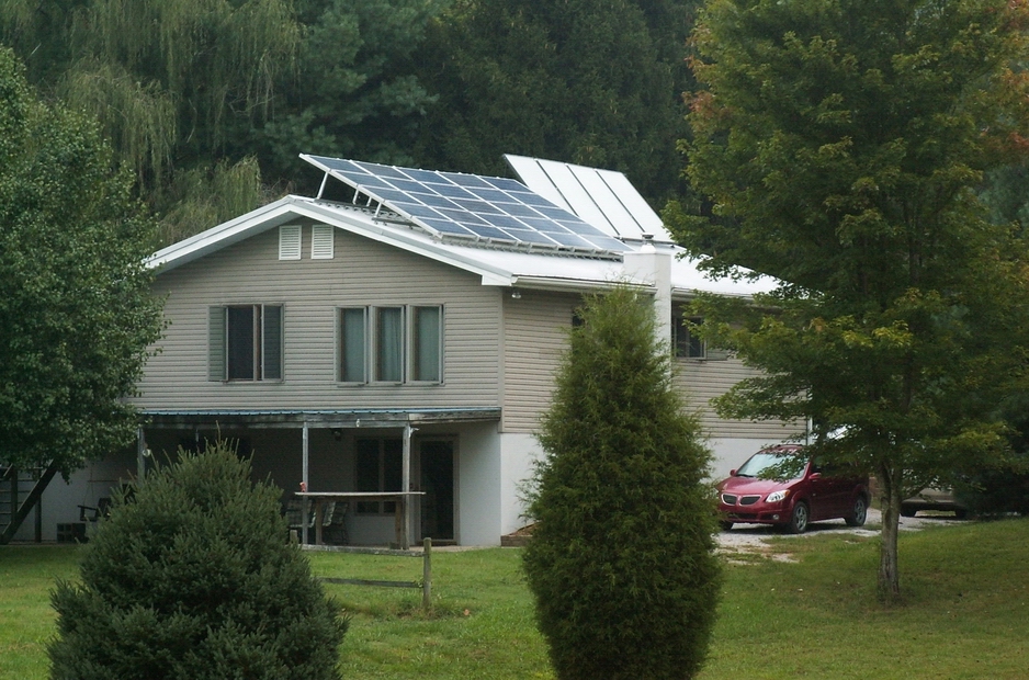

You might not know this is a net-zero home by looking at it — that’s the point
Creating at least as much energy as it consumes, this 1970s ranch on a lake shore in Tennessee resembles most other Middle American homes, which is a good thing. It is proof that you can work with what you have, don’t have to be fancy or complicated, and can accomplish a lot. Owner and renovator David Bolt says of his net-zero home, “We haven’t paid a utility bill since April 2006.”

He chose the route of efficiency and deep personal involvement, and did much of the work himself. Constantly improving on his efforts, he suggests you don’t have to do it all at once. His solar water system was improved five times as he surmounted inadequate information, rapidly advancing technologies, and discovering how to orient his solar panels for optimal summer and winter bias. Until he made this last change in 2007, for instance, they’d run out of hot water in October and had to warm it with electricity from the grid.
