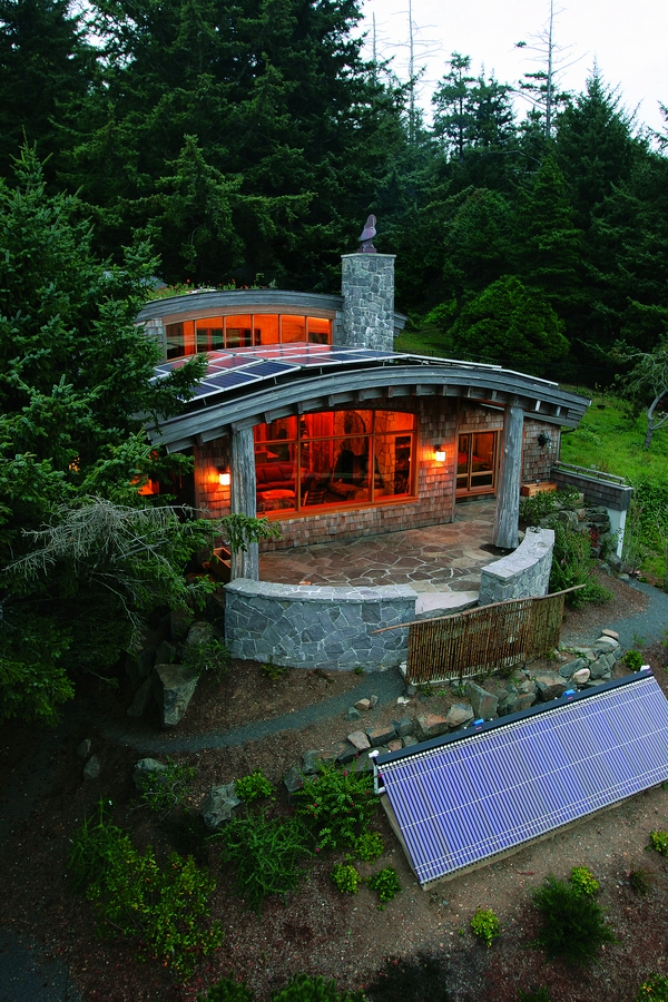

![](http://images.greenbuildingadvisor.com/app/uploads/2018/07/24233006/h177go_Image_0526-main.jpg)
Image Credit: Dan Morrison/Fine Homebuilding
