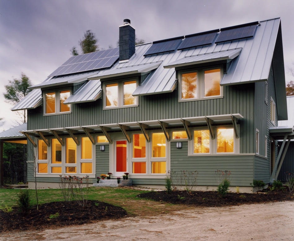

Image Credit: Wright-Ryan Construction A LITTLE BIT OF SHADE GOES A LONG WAY. With relatively wide temperature swings from summer to winter, Maine's climate demands seasonal strategies for maintaining indoor comfort. Deep roof overhangs and sunshades add only a small premium to the home's construction costs, but if well placed, they can add up to big savings when it comes to summer cooling loads - especially in a passive solar design. The operable casement windows on all sides of the house contribute further by allowing natural cross-ventilation.

Image Credit: Richard Renner ATTENTION TO DETAIL is evident in the strategies for letting heat in and keeping it in. The blower-door test result of 0.12 ACH @ 50 Pascals proved that Wright-Ryan built a tight house. Richard Renner thoughtfully integrated seasonal shading components and high-performance windows for effective passive heating and daylighting.

Although the supertight building envelope is the foundation of the energy-efficient design (with an impressive pre-completion blower door test result of .12 ACH @ 50 Pascals), solar electricity, heat, and hot water are integral features. The metal roof supports a 2-kW, grid-tied photovoltaic (PV) system in one corner and three evacuated-tube solar collectors (with 30 tubes each) in the other. Solar hot-water collectors set to work well in the cold New England winters can create too much hot water in warmer months. The solar domestic hot water system is designed so that it can direct excess heat into the radiant heating system, which could help the house coast through the shoulder seasons. As a last resort or when the heating system is not in use, a branch of tubing that runs under the garage slab will safely expel whatever heat the house can’t use.
The home takes advantage of passive solar heating as well. The three south-facing dormers have properly proportioned roof overhangs that allow only winter sun to directly strike the upper windows. The same scenario plays out on the first floor, but in this case there’s a clever bank of louvered awnings providing the seasonal shade that prevents overheating in summer.
