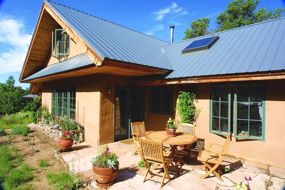

![](http://images.greenbuildingadvisor.com/app/uploads/2018/07/24232907/exterior-clay-straw-home_H147BA9img1743-main.jpg)
Image Credit: Kevin Ireton/Fine Homebuilding

Image Credit: Kevin Ireton/Fine Homebuilding Part of the environment. The main house nestles into the hillside on one level making it accesible and inconspicuous. The clay plaster exterior blends seamlessly with its surroundings because it is made from local materials. A metal roof collects rainwater into underground cisterns.
